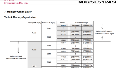

                              Now I try to do the same thing with External flash (MX25L51245G which is of 512 Mb). This flash is communicating through QSPI. Before I started with USB , tried QSPI communication on board standalone. It is also working fine.
#define STORAGE_LUN_NBR 1
#define STORAGE_BLK_NBR 16384 //total no of sectors present
#define STORAGE_BLK_SIZ 4096 // sector size is 4K
This snippet is from usbd_storage_if.c file, here for STORAGE_BLK_NBK  is 16384(number of sectors) and BLK_SIZ is 1096 (sector size).  Even i tried the smaller size as i did for RAM (100KB) still no luck.
The above pic is from datasheet. And mapping of QSPI API's with Storage Class i have done. However, it is not detecting in windows, couldn't see the disk there. Kindly guide me here.
Note : i am manually formatting the disk space through STM Programmer before flashing the code.

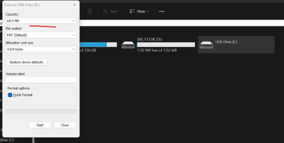

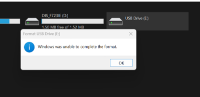

ShikamaruAuthor
Jun 12, 2024 2:06 PM UTC
Hi @tjaekel , @Tesla DeLorean ,
                     I can see my external flash in windows like below image,
before accessing it windows asks for formatting the disk. as soon as i hit format , it will hit STORAGE_Write_FS() (while debugging) this function  contains mapped QSPI  functions are there. I could see erase and write both are successful. However windows is not able to format it completely. It will through the error like "Windows was unable to format the disk". I am not getting the actual cause for the failure.
Note : FATfs is not yet enabled in firmware. I am formatting the external flash in STM Cube programmer.
