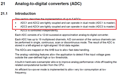

You need to refer to the reference manual RM0440 for that:
From ADC introduction:
The modes are described in the ADC section:
ADC1 and ADC2 can work together in Dual mode in specifically in "Regular simultaneous mode":
See figure 139:
Triple mode is not available on this product.
Hope I answered your question

Not sure what do you mean by "to measure few signals simultaneously."!

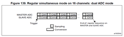

See figure 139:

mƎALLEm
June 12, 2024
Again, "6 ADC input simultaneously." is not clear.
The simultaneous mode is described in the RM, you can measure only two channels at time T with two ADCs.

mƎALLEm
June 12, 2024
"Does is possible by ADC1 and ADC 2
Input 1 then input 2, Input 3 to ADC1
Input 4 then input 5 , Input 6 to ADC2"
This is not a simultaneous conversion. It's a done successively ... and can be done by 2 ADCs in DUAL mode.
I've already shared a figure from the RM that fits your needs ..
And simultaneous conversion is something else, that's why:
"This is very simple question " -> Sorry this is not a simple question .. You need to find the right words to describe what you need ..
