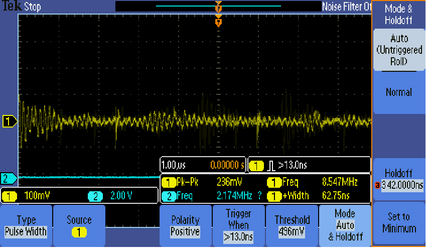

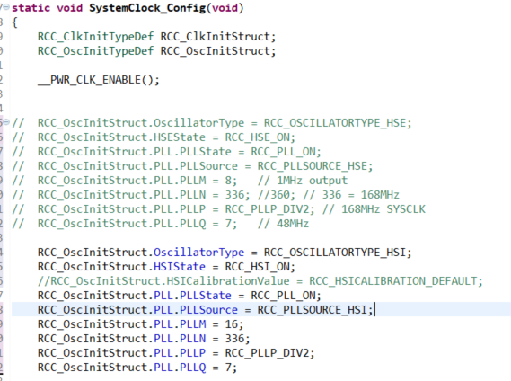

I have not done this test but I've confirmed that switching from HSE to HSI fixes the issue. So I've identified the HSE as the root cause.
It appears that the HSE is in fact the problem, details below....
KVIZK.1
*Update #2
I switched the PLL clock source from HSE to HSI and the SYSCLK transient vanished.
0693W00000GXoALQA1.pngSince this test I turned my attention back to the HSE since there is no other explanation that I can think of. It does appear that there is some measurable difference between a board with and without the transient.

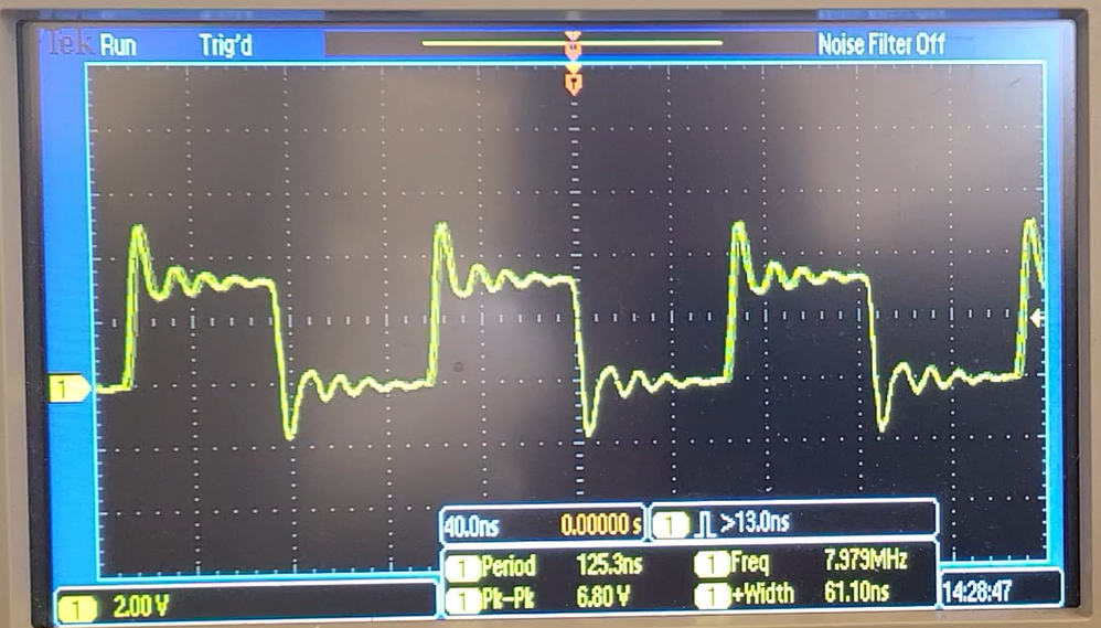

Good board - No SYSCLK or PLL transient

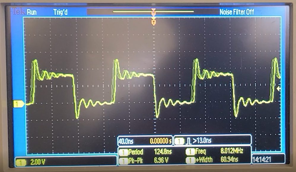

0693W00000GXoItQAL.pngBad board - SYSCLK and PLL transients can occur several times a minute0693W00000GXoJ3QAL.pngWe can see that the "bad board" has more ringing on the HSE than the good board and I believe this may have something to do with the issue.

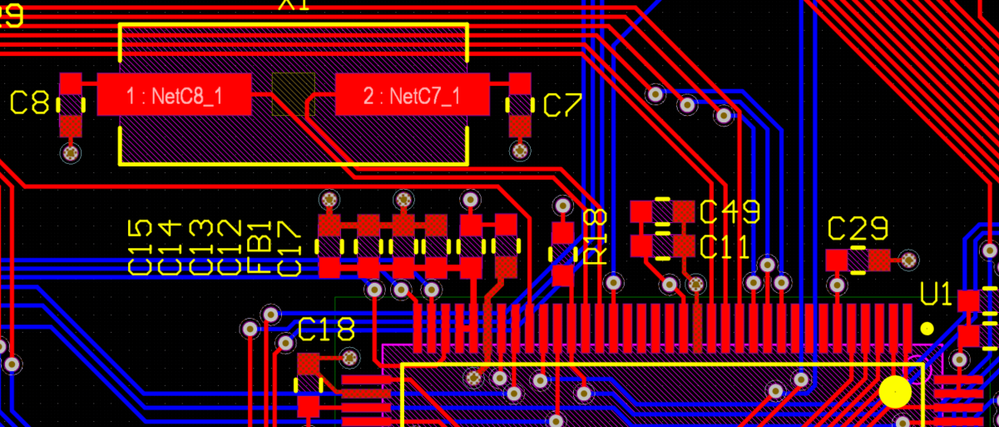

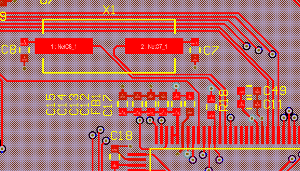

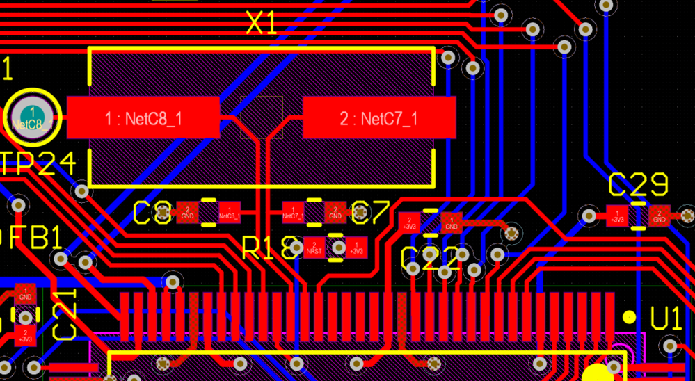

Here are some snapshots of the crystal circuits on good vs bad board. For reference my crystal is ATS08ASM-1E with 18pF load caps C7 and C8.
0693W00000GXoKLQA1.pngBad board - SYSCLK and PLL transients can occur several times a minute. This varies from board to board0693W00000GXoKVQA1.pngIt is also obvious (I think) that the xtal circuit layout on the "bad" board is not optimal and could explain why HSE on these new boards is not working as well.
This all makes sense and I can say that I found the root cause, but there is one annoying thing about this problem that I can't seem to resolve:

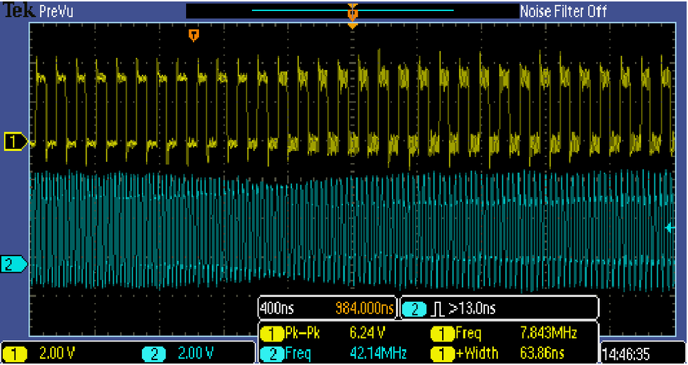

If I monitor SYSCLK and HSE at the same time I do not see anything significant happening on HSE during the SYSCLK transient
HSE (yellow) vs SYSCLK (blue) during transient0693W00000GXoLiQAL.pngNotice that the HSE is getting very noisy when the SYSCLK transient occurs and this is due to crosstalk from the SYSCLK signal affecting the HSE. When I disconnect the SYSCLK (blue) signal from the scope, the noise on HSE goes away. What I'm left with is basically nothing observable on the HSE while the board is having SYSCLK transients constantly.
Here's another capture with less crosstalk, this time HSE in Blue and SYSCLK in Yellow0693W00000GXoMbQAL.pngIt's hard to make out the HSE at this zoom level but there is nothing really obvious here. I can take more captures if anyone wants to see something in particular.

waclawek.jan
Show ground.
Does any power or HF current flow through that ground from the caps to the GND pin closest to OSC pins (probably VSSA)? Can this current be correlated to occurence of instability?
Or, the other way round - lift the capacitors and hang on them a wire connected to the GND pin closest to the OSC pins; and observe. PLL/oscillator can still be thrown off by impure VDDA/VSSA, though (I don't know exactly the internal routing of the chip).

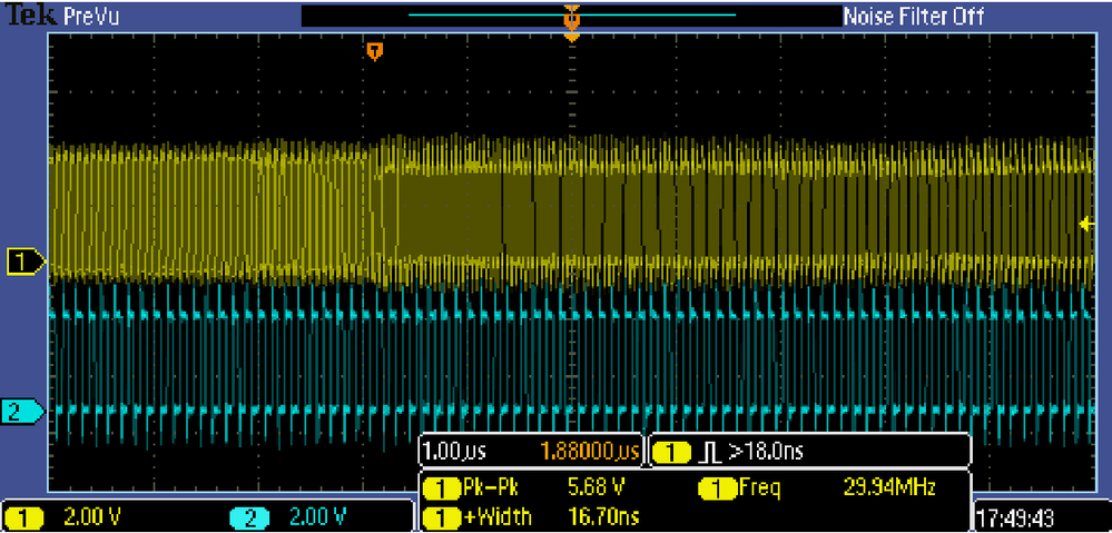

0693W00000GY3glQAD.pngI removed the xtal and load caps from the board and am now injecting an 8MHz waveform that matches the xtal signal from one of the good boards. When I do this the HSE as measured from MCO on my scope looks the most stable I've seen it. The transient is still present in this configuration though which is very surprising. Next test is to experiment with some series resistors on the xtal and then try this test on a good board. If the good board does not show the transient with an external generator that is wired in the same way then it seems to me that the HSE is not really to blame.
Of course the simplest and most likely explanation is that the HSE is to blame and I'm just missing something here....
