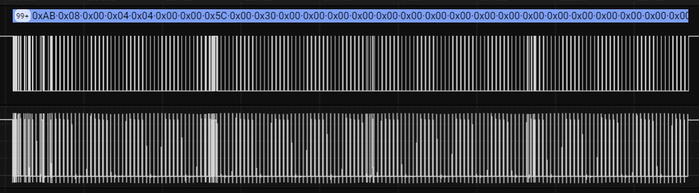

We have a packet that looks like this in the logic analyzer:
0693W00000FBOWIQA5.pngThe first byte 0xAB is the packet size of 171 (actual packet size is 172 with size byte included). When this packet is read from the DMA we will get all of the same data less 1 byte somewhere in the middle.
