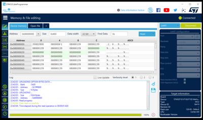

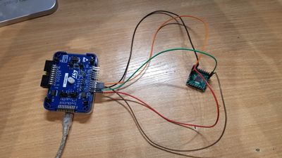

Cheers, voltage fixed by using the USB port connected to a power source - seeing 3.29V now. Also did a continuity check on all the wires soldered to the ST-LINK V3-MINIE, not pretty but those are good too. Still the 'no target' error however.
One clue? I connected the STM32F103C8T6 to an FTDI (USB to Serial) converter and was able to get the STM32CubeProgrammer to see the chip's memory using UART on the MCU's COM port.
In summary:
- Power's good now
- The CubeProgrammer is able to connect using an FTDI on UART (see below)
- Also able to upload and run code using the Arduino IDE
- The chip appears to have the ST logo, i.e. not a blue pill?
- The ST-LINK V3 still displays the same error unfortunately

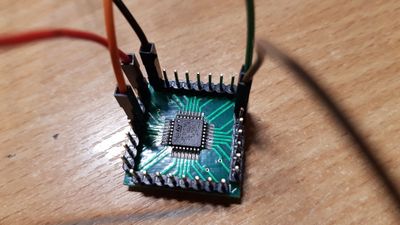

I took a spare STM32F030K6T6 in LQFP32 package. I soldered it straight to breakout board without any capacitors etc. I connected the jumpers for SWD programming. I guess this time it is as simple as it gets... I still get the same ,,No device found" error. I choose the lowest 5 Khz speed... Interesting, that logs show voltage of 0V, (VDD of STM32 connected to the VCC pin of stlink) And I also get same error text file as soon as I connect my stlink to the PC. I am clearly missing out some settings. Any ideas?

at this target voltage
st-link dont work - it assumes, no target can work at 0V .
so connect st-link vdd (input) to target vdd (3v3).
you have to connect 3v3 power to your target !!!! the st-link only checking voltage - NO power output !!!
‎2023-11-05 10:39 AM
On your image F030K6 require 3V3 on pins 1,5,17 and GND on pins 16 and 32 , i dont see it on wires...

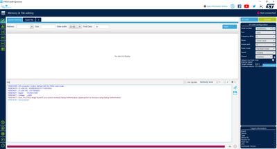

I am still getting the exact same error ,,No target found" if I am forcing to flash over and over again. However, If I disconnect the power from my 3.3V LDO, reconnect it again, the very first connection is made for around 3-5 seconds (connection settings such as speed or reset mode does not even matter, I can make it connect under different configurations...). After that, I get ,,Unable to get Core ID" error (same one I wrote earlier about). If I try to connect again without disconnecting power again, Its the same ,,No target found" error. I feel like my BGA PCB has nothing to do know, I am clearly missing some part of the flashing process. Any ideas?
