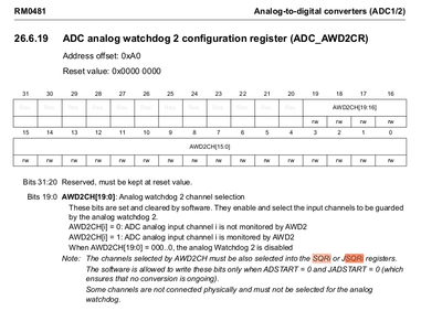

Hi
In the reference manual, RM0481 rev1, for analog watchdog window it mentions SQRi and JSQRi registers. I can not find any descriptions about these registers.
Can someone help me clarifying this?

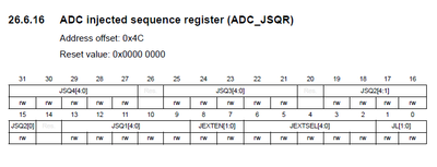

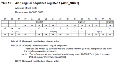

Starting from page 1128:
SQRi:
JSQR:
Meawhile, I think it woul be better to rename them with the corresponding naming used in the documentation starting by "ADC_"
For JSQR, there is only one regiter so no need to add "i" at the end.
I'm escalating this internally to confirm and get back to you with a feedback
