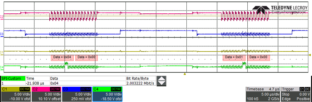

This is how my transaction looks on the scope. Clock (Red), CS (Blue), MOSI(Green), MISO (Yellow).
The signal on MISO and the received data are not as expected, I don't understand why. I believe i am doing something wrong in the initialization stage. Any useful tips or pointers would be helpful. Thanks.

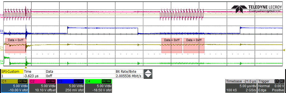

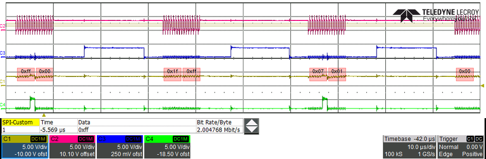

This screenshot is from the TI side. SCK (RED), Data IN (Green), Data Out (Yellow), CS (Blue)0693W00000KaQKnQAN.png
I believe the chip itself might be damaged.
waclawek.jan
Try with the original TI master, measuring at the same place, compare/post waveforms.
