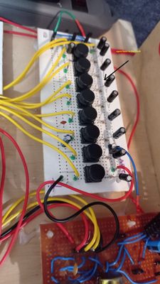

I configured the EXTIs for 16 inputs from PD0 to PD15, rising and falling edge, IRQ1 for PD0, IRQ2 por PD1, and so on as must be for groups 5-9 and 10-15 IRQ Handler. I debug the program with a breakpoint in each EXTI_IRQ_HANDLER and all of them are activated when I press a button. I found the behavior of the callback because of this but I do not know the cause.
What button? What exactly is the hardware? Can you post a photo? Can't it be that that button indeed causes a pulse on all pins of PD (e.g. through inadequate common ground)?

2023-10-06 10:12 AM - edited 2023-10-06 10:38 AM
Thank you for your ideas, I got a new path because of you to look for and I found when I press a button it's created an spike that triggers to all inputs EXTIs, I'll look for a mistake or something in the hardware. I got an oscilloscope to do this, I need to buy one.
Post relevant portion of schematics, and a photo of your setup.
2023-10-06 2:31 PM
Hi, I found a broken track in my pcb, it looked fine when I tested with a multimeter for continuity but when I pressed a button the force applied opened the track and isolated the ground connection of my debounce capacitors giving an spike in almost all inputs

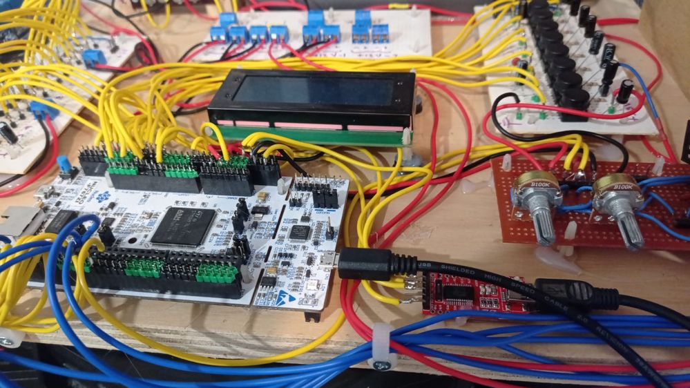

2023-10-06 2:34 PM
this is my project!!
