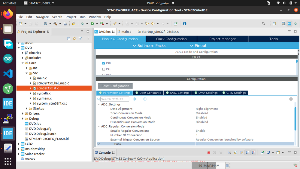

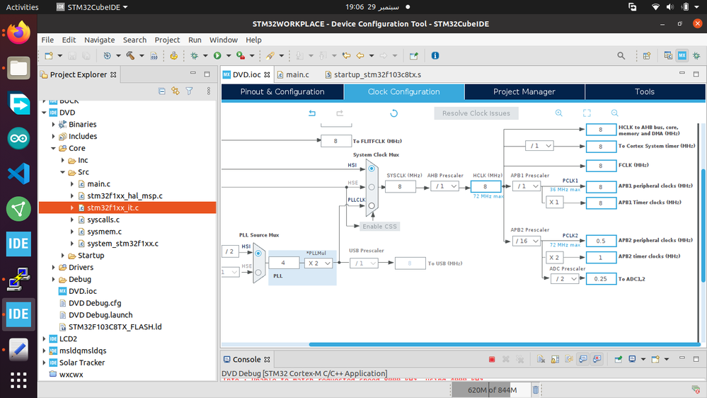

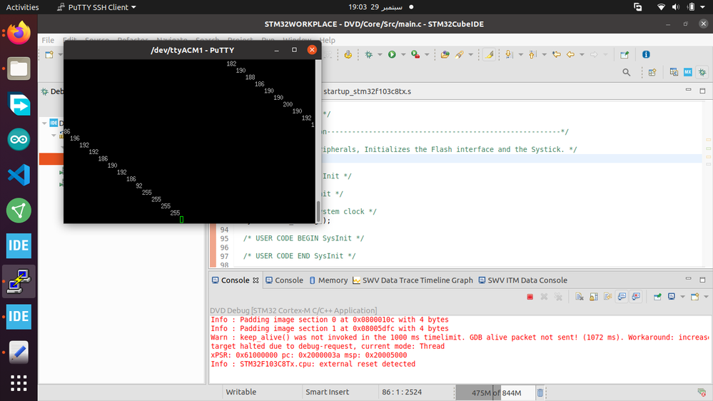

This has been a reoccurring issue for me, whenever I raise the ADC frequency above 0.25MHZ the while loop gets interrupted, and when I use frequencies below that the ADC resolution drops to 8 bits for an unknown reason. Is there a way to fix this without having to use poll for conversion or IT?
note: I'm using cubeIDE.0693W00000FAuNaQAL.png0693W00000FAuHxQAL.png0693W00000FAuMXQA1.png0693W00000FAuMDQA1.png0693W00000FAuLLQA1.png

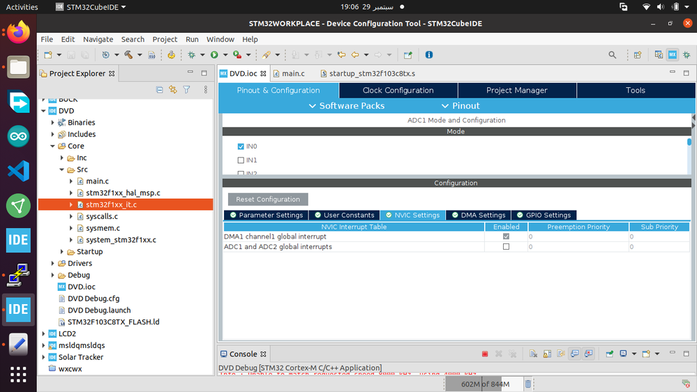

Trick would be to NOT interrupt after EVERY SAMPLE
At 250 KHz you've got a lot of time wasting interrupts/callbacks
Decimate the interrupt loading by taking 10, 100 or 1000 samples between callbacks
and how exactly does one do that ? excuse me if it's something obvious because I'm rather new to micro-controllers and such.
Also , how come the ADC resolution drops to 8 bits?
No real idea how you're making that determination, you're loading a 12-bit (16-bit) value into a uint32_t

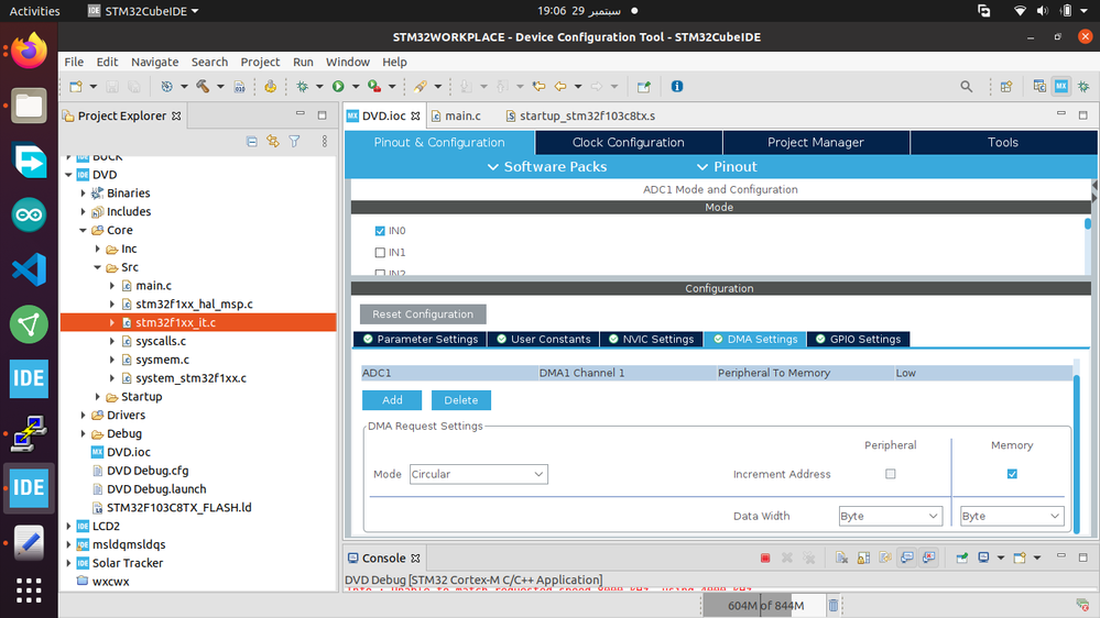

as it turns out, I set the data length to byte instead of word which is why i was getting small values.
