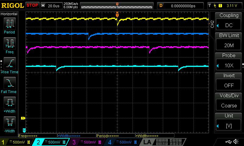

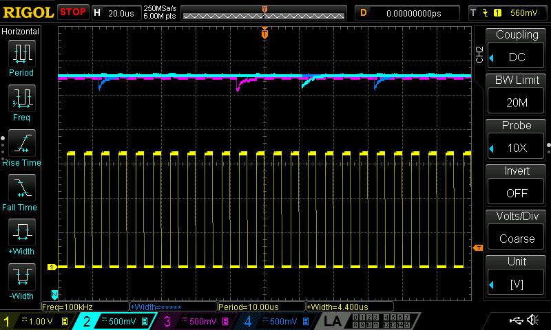

2020-05-23 6:09 AM
I am using NUCLEO-G474RE as my hardware.
STM32CubeIDE V1.3.1 and STM32G4 Fw V1.2.0.
I am using ADC2 with 4 channels triggered by HRTIM CH B Compare 4 Injected.
So these 4 channels are triggered interleaved, meaning that every HRTIM-CH-B Compare 4 only one ADC channel is triggered according to rank.
So for 1st occurrence of Comparewill trigger rank1 then the second compare it will be rank2 so on and so forth until it gets back to rank1 again.
I can see that the S/H is working as shown in the waveform below.
The circuit is similar to HRTIM cookbook section 7.1 Debugging ADC operation.
Below is the HTRIM output
My setup for ADC2:

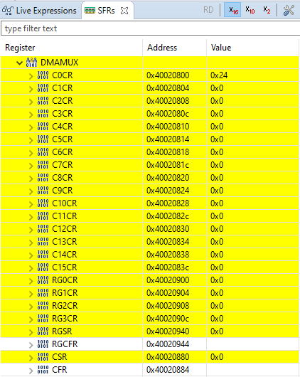

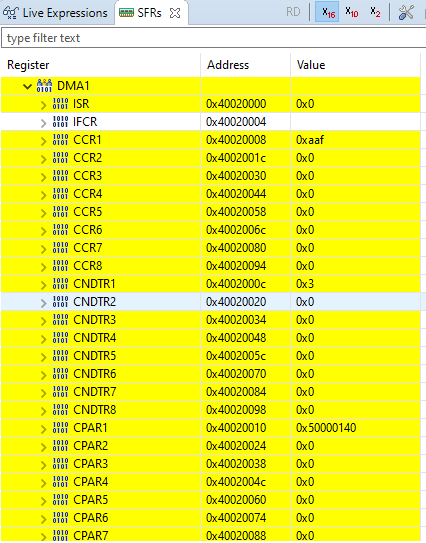

2020-05-23 5:33 PM
So far this what I get from DMA1 and DMAMUX, reading RM now...
after
if (HAL_ADC_Start_DMA(&hadc2, adc_four_ch, 4) != HAL_OK)
HAL_GPIO_WritePin(GPIOA, GPIO_PIN_5, SET);
BTW, I forgot to remove one old code:
VoutMeasured = HAL_ADCEx_InjectedGetValue(&hadc2, ADC_INJECTED_RANK_1);
seems to work though, I can get values...
even I comment the above code, still no values for my array..
