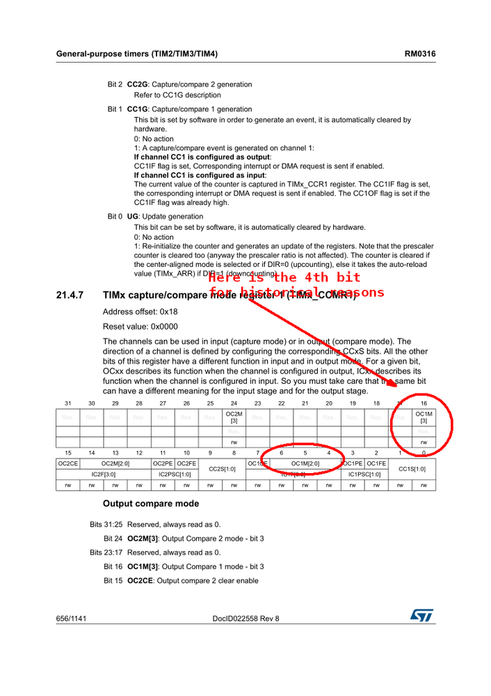

Another question:
In the RM0316 file, on page 658, talk about "Bits 6:4 OC1M: Output compare 1 mode". That are 3 bits, but in the description it shows 4 bits. Whats wrong here?:
These bits define the behavior of the output reference signal OC1REF from which OC1 and
OC1N are derived. OC1REF is active high whereas OC1 and OC1N active level depends
on CC1P and CC1NP bits.
0000: Frozen - The comparison between the output compare register TIMx_CCR1 and the
counter TIMx_CNT has no effect on the outputs.(this mode is used to generate a timing
base).
0001: Set channel 1 to active level on match. OC1REF signal is forced high when the
counter TIMx_CNT matches the capture/compare register 1 (TIMx_CCR1).
‎2019-11-13 3:31 AM
@Imen DAHMEN​ I almost certainly bragged about this in the past: can please in *all* RMs and *all* TIM chapters where this extra OC1M bit is, a footnote be added to the Bits 6:4 OC1M description, saying that OC1M[3] is to be found elsewhere?
‎2019-11-13 3:49 AM
Thank you very much again, friend! :)
‎2020-02-28 8:24 AM
​Hi @Community member​ ,
I'll take care of adding the note.
For the newest versions, we have changed the description as below:
Best regards,
