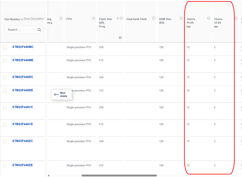

@HMSEdinburge wrote:
Hardware timers all use up
Really?
It looks like the F446 range has 14 timers:
https://www.st.com/en/microcontrollers-microprocessors/stm32f446/products.html

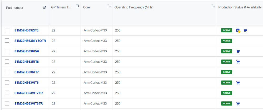

And there are STM32s available with up to 22 timers:
https://www.st.com/content/st_com/en/stm32-mcu-developer-zone/mcu-portfolio.html
