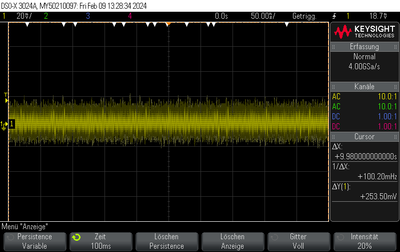

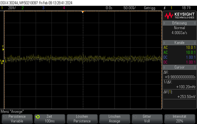

thank you for your valuable input. Crosstalk from other pins was also one of my attempts so i used my (of course not the fastest one) to inspect the problem-trace.
Coupling was AC to filter the DC-part and to bring the signal down to GND, for better scoping. GND-Spring to have lowest possible GND-Loop (only few mm) to reduce extra noise due to the scope probe. And i scoped the via, directly near to the BGA, not to miss anything.
first one is without FMC-communication
second one with running FMC-communication (Be careful, it looks worse than it is due to the "Persistance-overlay" view of the scope.)
so, of course the noise level rises, but all within +/-20mV compared to the 200mV pin-hysteresis, i would say, this can not be the cause. It should be an easy one for the Schmitt trigger to filter this small noise.

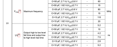

--> Try : setting all FMC outputs/pins to medium or low drive speed, depends on your speed for FMC, try little bit low speed , to prove this.
btw
the medium setting still can work up to 80...100MHz :
‎2024-02-12 8:01 AM

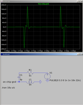

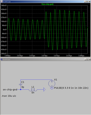

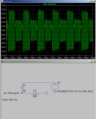

To check on your board : set the "bad" exti pin -> to gpio out, low . Then remove the filtering cap on the line and look with scope, whats coming out from "there" . You might see, whats the internal "gnd" doing , compared to gnd outside.
Just to know: is this the problem - or something else...
just for fun:
simu, what will be internal gnd bounce, at 3pF pin capacity and about 20mm from chip to gnd (= about 20nH line)
surprise, surprise : at 1ns rise/fall times you might get +/- 1V spikes...sure enough to trigger 200mV sm levels.
(= thats external 1ns rise/fall driving the 3pF pin capacity... )
Now if you optimize layout..and get real distance chip-gnd to 5mm -- 5nH :
-> stll 450mV spikes
Now 5mm with 51 r in line :
yepp. 200mV max spike.
