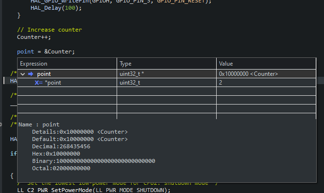

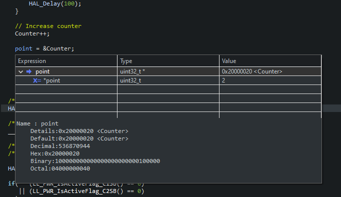

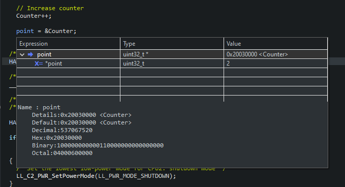

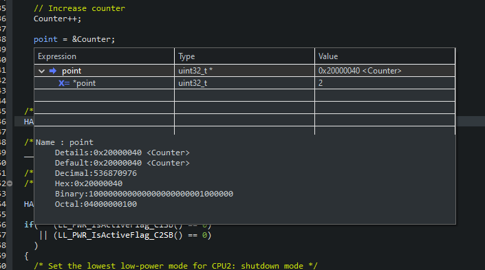

lizerd
Okay this is wired..
I have been adding this to my linker script, always been and it has worked for all STM32L4 variants I have used before.
Adding RAM2 (here I have been testing the mirror address of the SRAM2A)
MEMORY
FLASH (rx)                 : ORIGIN = 0x08000000, LENGTH = 512K
RAM1 (xrw)                 : ORIGIN = 0x20000008, LENGTH = 0x2FFF8
RAM_SHARED (xrw)           : ORIGIN = 0x20030100, LENGTH = 2K
RAM2 (xrw)   			   : ORIGIN = 0x10000000, LENGTH = 2K
and
  .ram2 (NOLOAD):
    _sram2 = .;
    *(.ram2*)
    . = ALIGN(4);
    _eram2 = .;
  } >RAM2
and the variable
volatile uint32_t Counter __attribute__((section(".ram2")));
and it has worked.
I have played around with the RAM_SHARED and RAM2 address and length, and I found a strange thing.
I accidentally used an ref that I did remove in the linker script.
So I had static __attribute__((section(".sram2"))) uint32_t Counter;
.sram2 do not exist.
But I it worked, the led starting to increase blinking for each iteration, So the variable was preserved!!.
Checking the variable address showed in the beginning of SRAM1
But if I changed the variable declaration to static uint32_t Counter;
then it did not work, it did not preserve the value
And the address was just a few bytes from the address when it worked !!
And then I also tested the mirror address for SRAM2A
0693W00000GWVEgQAP.pngAnd that did not work
I am going crazy here :loudly_crying_face:
