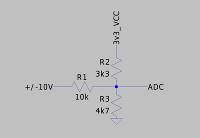

my first question is how to measure negative voltage without letting user to do any options?
I was thinking to use voltage adder to add a fixed voltage to my signal, and then simply sample on both channels (signal and fixed voltage) and negate values to get absolute value of my signal.

If you use "standard" VDD = 3,3V and (3v3 = VDDA=vref+ ) , ADC can convert 0...3,3V ;
most simple solution is using a divider at input, + offset , like this:
But dont forget : do always "reference zero calibration" , because 0,0V input is about half of full scale at adc input.
So to get some +/- result, you have to do:   (adc_value) - (adc_value at 0 V input) = (+/- result)
