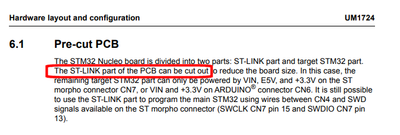

@marcogrossi89 wrote:
However, if I remove the ST-Link part of the board, how can I reprogram the MCU
Read the rest of that paragraph:
Here's a picture from @MM..1 showing where to break:
Taken from this post: https://community.st.com/t5/stm32-mcus-products/stm32-mcu-choosing-and-programming/m-p/657536/highlight/true#M239953

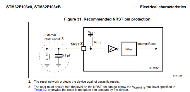

If you power supply the MCU through JP6, what will be the power supply of the STLINK module? here you will only power supply the MCU. The removal of SB12 will ensure that STLINK will not assert the reset in this state.
You need to look deeply at the schematics to understand the relationship between the power supplies.

Regarding the removal of SB12, at what voltage level (GND or VDD) should I tie T_NRST on CN4 to guarantee STLINK will not assert the reset with SB12 present?
There is an internal pull-up resistor on NRST pin inside the chip. No need to pull it up/down. CN4 is the connector for an external STLink usage, I don't see the relation here! You need only to disconnect SB12 to disconnect T_NRST output of ST-Link from NRST of the MCU.

I do not understand very well. The removal of SB12 assures that ST-Link is not able to send reset commands to the MCU. However, when I remove JP6, the ST-Link is not powered. Since, as explained, NRST of MCU has a pull-up resistor inside the chip to prevent reset from noise, how is it possible that ST-Link sends a reset command when it is powered down, even if SB12 is present?
You don't tie NRST to anything - it has an internal pullup:
When the ST-Link is powered down with SB12 present,  it would pull the Target's NRST pin down.

Probably the simplest approach without soldering would be to simply break-off the ST-Link part of the board - it is designed to do that.
marcogrossi89
However, if I remove the ST-Link part of the board, how can I reprogram the MCU if I need to do that? I do not need to measure sleep currents but the value of the high and low thresholds of the schmitt trigger circuit integrated in the GPIO interface for pins set as digital input.
