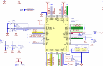

I'm having a problem with the LSE/RTC and I'm not exactly sure where to start, but I'll try to explain it.
I'm using the STM32WB55 and the RTC is used for FreeRTOS tick timing. It works perfectly during normal operation with a 1 ms tick, and it also works when entering STOP2 mode and waking up after a longer time, for example 2 seconds. The RTC is clocked by LSE.
However, the problem occurs if the ST-Link is connected to the SWD header. In that case, the RTC no longer wakes up the MCU from STOP2 mode — the MCU just stays stuck in sleep mode, like the RTC didn’t generate the interrupt or didn’t wake it up.
It also seems to be related to power cycling. If I disconnect the power supply from the MCU and wait long enough (more than 5 seconds, to fully discharge the board), then reconnect power, this issue always happens. But if I just reset the MCU without cutting the power, everything works fine again.
I also found that the problem does not occur when using LSI instead of LSE.

I would also suggest routing the LSE clock to GPIO pin to see if LSE is running fine.

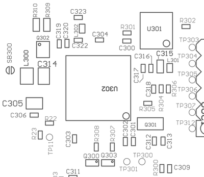

Also, would it be possible to share your PCB design or any other debugging test? Thank you.

If you can check anything, there is schematic:
I do not have PCB layout now, but only this:
If anything could be wrong, please let me know. Thank you very much.
