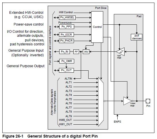

  1. Increase connection flexibility on I/O pins: currently we can select for each pin a single signal that can be "source" or "destination", ie input or output from the pin, this creates limitations. The greater flexibility if the "GPIO alternate function" are used ONLY to select source signals when the pin works as an output, because it is impossible to have more than one source to send to the digital output. The input signals (ie destinations to the various peripherals) should ALWAYS remain active whatever the use of the pin (Input or Output), because this does not create conflicts. Subsequently, in the various peripherals where these signals arrive, it will be possible to select which input to use for a function. In this way I can send the signal present on an input pin to several peripherals at the same time (Timer, SPI, etc.), I could command an output with a PWM and simultaneously verify that it is working properly by means of a timer that picks up its status logical. All this is what some competitors do (for example the Infineon XMC series), as you can see the "alternate" are only signal sources to send to the output transistor, while the logic state of the pin is unique and goes to some peripherals, which can also be used simultaneously. Look at this: 0690X000006D9eMQAS.jpg
