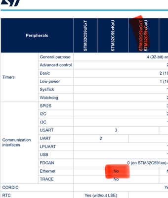

I am trying to learn how to program a STM32 micro-controller, specifically a STM32C593. The thing is according to its datasheet it has Ethernet functionality, bit it is missing in the peripheral list inside STM32CUBEMX2 IDE.

Hello @accf1996
Could you please give the full part number to check. According to the table 1 of the DS15136, Ethernet peripheral is not available on some of the STM32C593 MCUs.

I am trying to work with STM32C593CET6. I am looking for a low pin count device that has Ethernet functionality for a handheld device. The thing is according to its datasheet and the block diagram that appears on it that MCU has Ethernet capability.

Hello @accf1996
According to the table 1 of the DS15136, the STM32C593CET6 does not include an Ethernet peripheral:
The smallest package that supports the Ethernet is the LQFP64 on the STM32C593RE and the STM32C593RG.

Thanks for your help. I selected that device using the MCU Portfolio selector. If I filtered the device selection by "Communication Interfaces" and "Special Interfaces" fields the MCU reference appears. Maybe I am using incorrectly the MCU Portfolio tool.

You are right, it seems to be a limitation on the STM32 MCUs portfolio filters. I’ve reported this issue to ST people here for correction. It is always better to double Check using the datasheet for such cases.

@accf1996 - Seems that it is now fixed.
