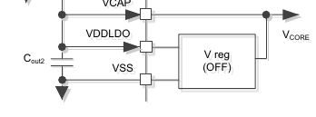

The thing is, I started measuring the power source pins just in case I spotted something weird, and I sure did: my VCAP pins are at 2.2V, which is strange because they should be at 1.2V according to the internal LDO regulator.
My guess is that this may be the source of the problem — an incorrect power source for the flash memory — but I’m not sure.
Here I attach my squematic.

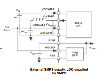

Just a simple question: you write : STM32H747BIT6
but you use only LDO - why?  afaik it should be using smps + LDO (for max speed)

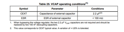

and vcap 2.2 uF ....not your many caps...
Try to change the vcap and check (if cpu still alive...).
And no, its not a fake. Maybe its a damaged cpu now.
"but you use only LDO - why?  afaik it should be using smps + LDO (for max speed)"
Correct me if I´m wrong but I think for the max speed is only necesary the LDO, but I´m not sure.
I also tried removing the VCAP capacitors leaving only two but no diferent result.
Do you think it could be worth trying to bypas the voltaje regulators and supling the 1.2V externally to se if the cpu is okey?
That should work....but is just a experimental attempt. LDO input should be...same, 1.2V .
vcap IS the core voltage.
Try with watching the current, while rising from 0 to 1.2V ; if current goes > 200mA ...forget it.
If lower...maybe still ok. Should connect then , VDD at 3v3, to st-link. Then you know...
