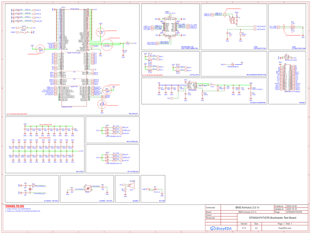

Im working on a large and expensive project that requires dual core processing, therefore prior to committing to the cost of my project I created a custom dev board  to ensure I can achieve what is required for my project.

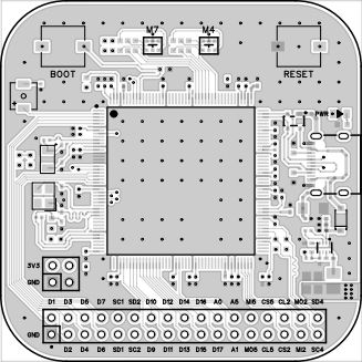

My dev board I am soldering components using stencil and reflow plate. The Chip connects to Cube PRG and runs code I upload

I believe my issue is related to soldering/bridging, which is creating a short,  therefore Im going purchase more boards fully assembled by JLCPCB, however before I do so I would appreciate the community review my design below in case Im missing something obvious, thanks in advance.

seems mostly ok, but whats wrong:
you connected Vdd12dsi to 3v3 , killing the chip. or create big current...if still alive.
you connected Vlxsmps to GND, but it should be open.
-- So try: disconnect (cut pin ) Vdd12dsi and Vlxsmps . See if chip still alive...or replace with new chip.

Hi AScha
Thank you for you for your reply , iv cut the pins as you have suggested, This worked beautifully, Temperature has gone, currently drawing 215mA and VCAP pins now reading 1.2v.
disappointed in myself to be honest how I have missed this, just went over the manual again, its black and white, thankfully chip survived!
Thank you very much!
