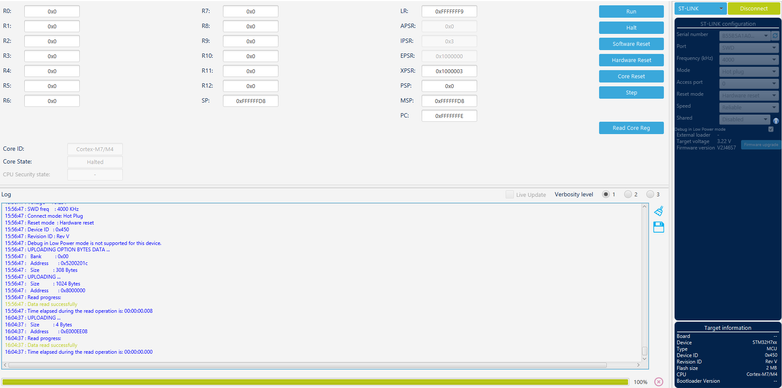

Btw, here is a picture from stm32cubeprogramer whith info of the mcu

> every address is at 0, which makes sense given that I haven’t uploaded any code to the microcontroller
If the microcontroller is fresh, all flash is at 0xFF, not 0. Likely there is an issue actually reading the memory. Probably due to the underlying hardware issue.

If the microcontroller is fresh, all flash should be at 0xFF, not 0. It’s likely that there is an issue actually reading the memory, probably due to an underlying hardware problem.
Speaking of this, something I have noticed is that sometimes the memory shows 0xFF when connecting, but I don’t know why or when it happens.

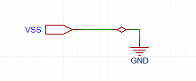

Why separate VSS and GND? A strong ground connection to ground at each VSS pin would be better. I suspect this might be the issue.

Also, VSS and GND are on the same line, (not my best schematic design decision).

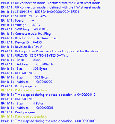

These are the logs that show up when I connect the board

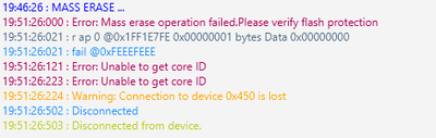

and these are the logs when I try to erase the flash

This is a hardware issue. Correct the hardware issue and the software problems will go away.

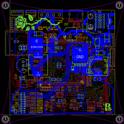

Can you show your layout? Large in-focus pictures of the board with the fixes you made may help too.

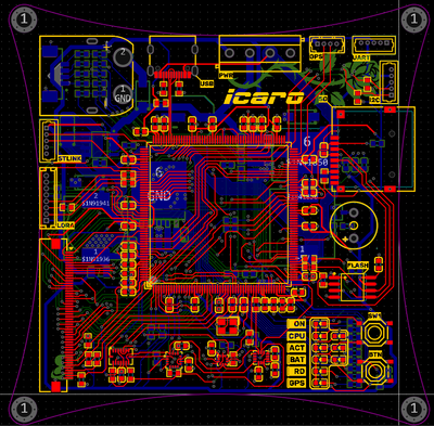

Here I attach the altium pcb file, the VBAT and VCAP corrections are not here as I used some wires on top of the pcb for the conection.
I can't view Altium files, unfortunately.
Sorry, I don't know how to share the proyect, do you know what kind of file could I share you?
