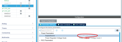

I have been working recently on a board that i have made for a flight computer. But unfortunately, I have encountered some problems while programing the board.
The conection to the board works great, and I´m able to upload de code and read it. The Issue comes when I try to make the code run that the board does not do anything. I have the doubt of it being a hardware or software problem as I did the design of the board.
Here I adjunt some of the evidences that I have been looking in case someone needs them to provide and answer:

To reprogram the board I'm forced to acces throught BOOT0 = 1, if I don't do this the MCU it is not recognised and shows unable to get core ID

  HAL_PWREx_ConfigSupply(PWR_DIRECT_SMPS_SUPPLY);
This doesn't match your schematic. You want PWR_LDO_SUPPLY.

Change it here:

Thank you so much. I just wanted @TDK to let you know that you have helped someone not only troubleshouting a simple error but to acomplis his goals and enjoy this hobby. Thanks for your work.
