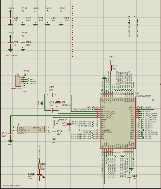

You don't mention what you have connected to the NRST pin, nor the crystal or oscillator circuit.  Can you post portions of your schematic related to power, reset and external crystal (if you are using one).
Thank you for your reply.
Yes, it's when  I use a debugger - ST LINK V2.
The only thing That I've connected to the NRST pin is a 100nF capacitor.

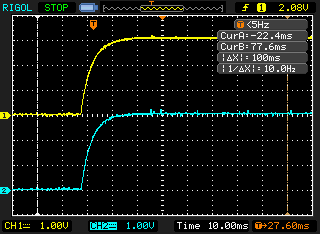

I've also made some measures (in yellow the card which starts everytime and in blue, the one which starts sometimes).
NRST :
NRSTNRST

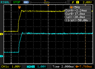

VCAP :
VCAPVCAP

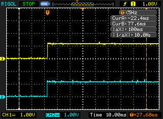

 VDD :
VDDVDD
DESIGN :
Perhaps blink an LED before SystemClock_Config and then again after. Perhaps it's getting stuck in there.
If power is valid and NRST is high, which it looks to be, the chip is running something.

I think I've found the solution. I put two capacitors for LSE (22pF).
But the crystal that I choose needs 12pF. I've made the modification and now it starts each time.
