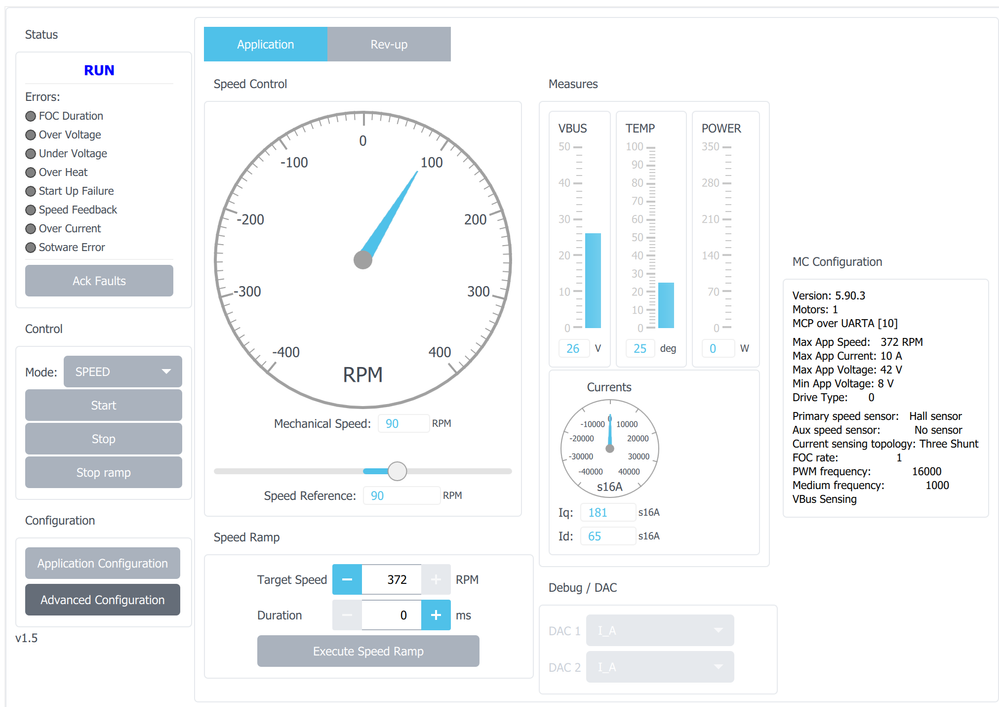

It turns out that the "Motor pilot" application returns a completely correct zero current value in s16A units, but the MC_GetPhaseCurrentAmplitudeMotor1(); behaves strangely. I would agree that this is a polarization of 2.057V, but the function should return not a 12-bit ADC value, but a 16-bit value, that is, there is some processing up to the s16A format.

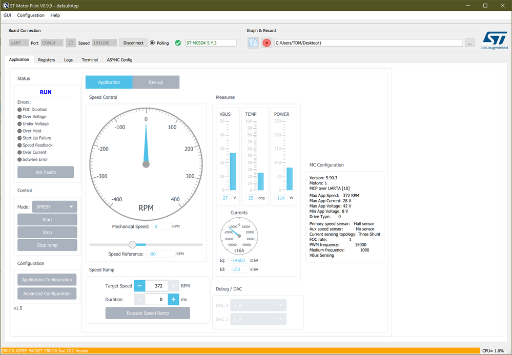

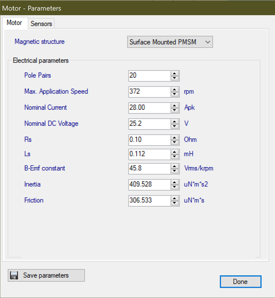

And one more thing that I do not understand when measuring current is why the measured current is so large, about 15000 units, although the power is just over 100W. My application is designed for 28 Amperes of maximum current and it seemed to me that the number 15000 should correspond exactly to 28A if I indicated it in the engine settings. This number in file drive_parameters.h
#define IQMAX 15246
It really depends on the set current of the motor and it will be really true about 15000 for a current of 28 Amperes according to the formula given in the previous message, but I am sure that in reality I do not see this power even close.
Explanation to get a high current at zero speed I am blocking the motor. And I get about 114 watts, which is about 3-4 amperes.
The second moment when the current rises I start to get a Bad CRC Hader error and this knocks down the control through the motor pilot.
Oh, I found exactly the same question with exactly the same results as mine. There is also no answer in this thread, but the main question is not even why the current function does not work quite correctly, but why the current is generally measured incorrectly, and a large current leads to data transmission failure.
