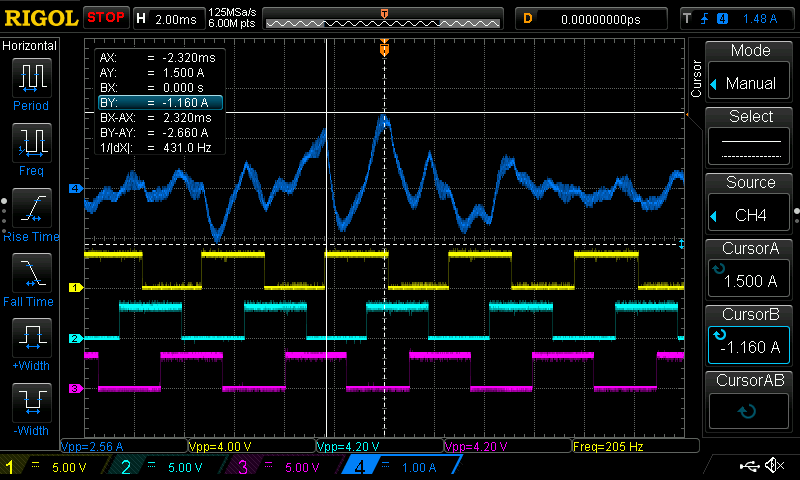

I keep investigating why I have problems driving my motor with negative speeds.

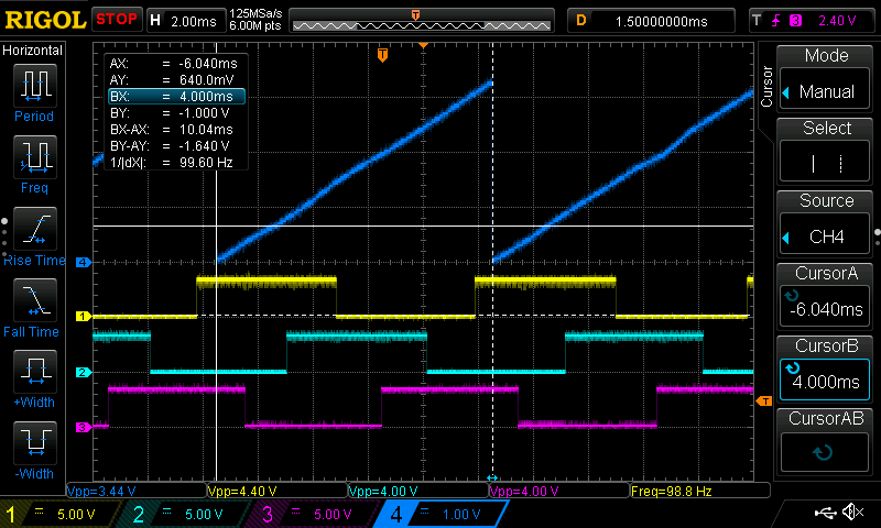

I captured the phase voltage directly on the motor leads (yellow, cyan and magenta channels) and the current on the DAC output (Ia or Ib) and I noticed this peaks on the current waveform.
Zooming in, the currents themselves don't look bad at all
However I do not understand where does peaks are coming from
0693W00000JODRdQAP.pngAny ideas will be greatly appreciated.

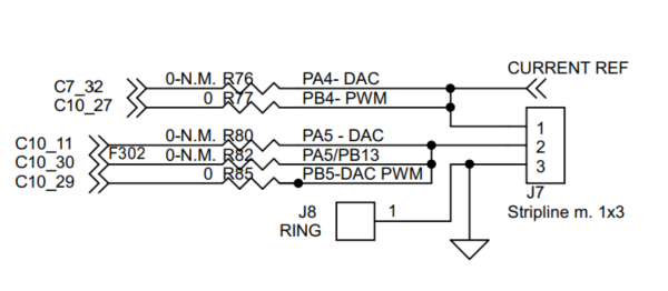

I'm measuring the current from the DAC output (don't have a current probe available at the moment). I'm connecting the oscilloscope in the middle pin of J7 and its ground lead connected to the test point J8.
MK.1
Senior
Look carefully at the board diagram and you will understand that the signal from the DAC does not get to this connector in any way :)

Well, after a lot of testing, I want to log my experience here in case it helps somebody else:
While looking for a solution to my problems I stumble upon this thread, he had the same setup as me, it turns that I was measuring just noise (and the PWM). In summary, the IHM08M1 is somehow targeted to be used by the Nucleo F302R8 and the Nucleo F401RE and if you are using something else (like in my case Nucleo F303) you will need to grab the soldering iron and fiddle around with some resistors.

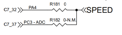

  • Remove resistor R181

  • Connect the correct DAC output (PA4) to the J7 pin header, for this the R77 has to be removed and the R76 installed.
  • Connect the correct DAC output (PA5) to the J7 pin header, for this the R82 and R85 have to be removed an the R80 installed.

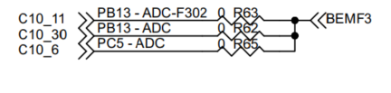

  • Remove R63, it conflicts with BEMF3

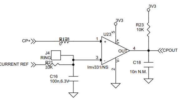

  • Remove R21. This is also used CURRENT REF which is input to OpAmp through a low pass filter so in the case of Observer Electric angle, the saw-tooth will appear chopped at the end. In my case maybe this wasn't necessary as I do not use the observers.

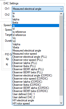

0693W00000JPGYPQA5.pngWith all this changes I was finally able to see the DAC output in my oscilloscope and cycle through the different variables without recompiling.

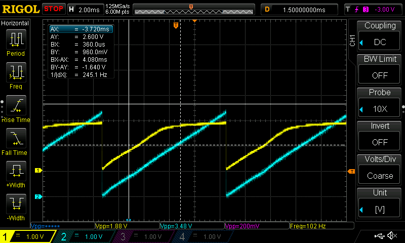

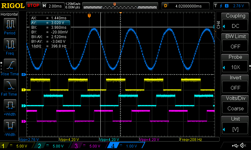

0693W00000JPGauQAH.pngUnfortunately for me, only the DAC Ch1 seems to be working properly, as I get lots of distortion in Ch2. Here a screenshot of both channels displaying the "measured electrical angle"
0693W00000JPGY1QAP.pngBut the one channel that works, seems to be working properly
