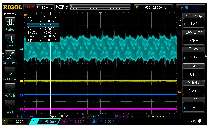

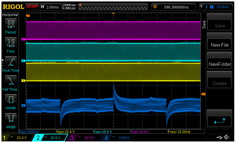

I keep investigating why I have problems driving my motor with negative speeds.
I captured the phase voltage directly on the motor leads (yellow, cyan and magenta channels) and the current on the DAC output (Ia or Ib) and I noticed this peaks on the current waveform.
Zooming in, the currents themselves don't look bad at all
However I do not understand where does peaks are coming from
0693W00000JODRdQAP.pngAny ideas will be greatly appreciated.

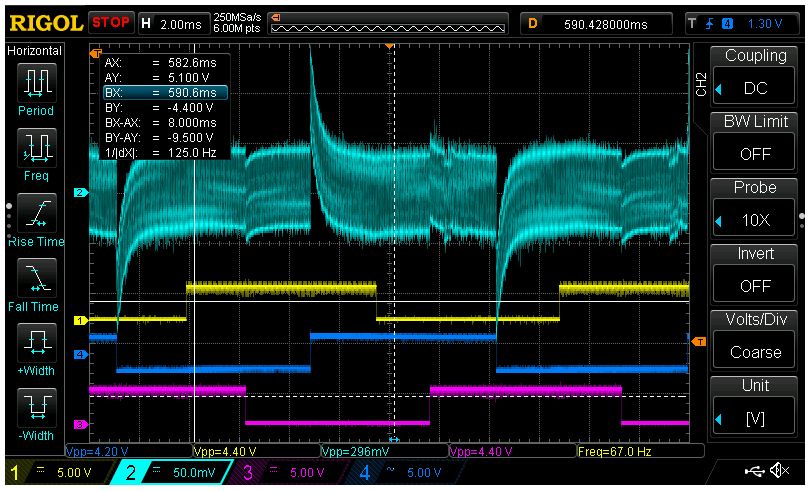

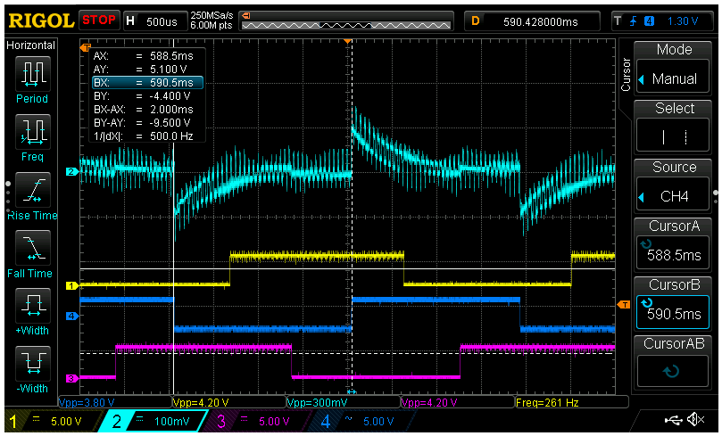

Apparently those peaks in my current signal are somehow correlated to the switching of the hall sensors, instead of measuring the voltage in the motor phases, I measured the hall sensor signals and the output of the DAC (Ia or Ib current) and those peaks appear exactly when the H2 (on the J3 header of the IHM08M1) switches.

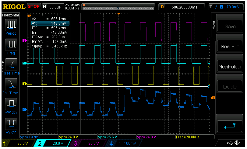

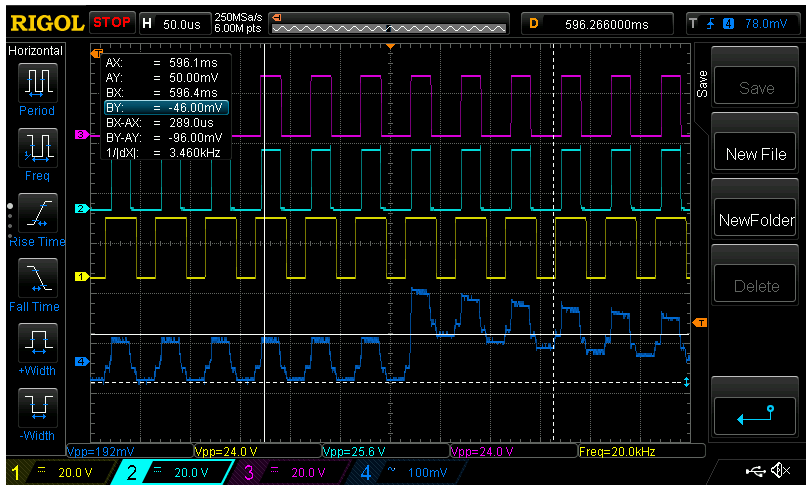

I created a new dummy project using a sensorless approach, but still with the hall sensors connected to the board, the strange waveform is still present
0693W00000JOHqwQAH.pngHowever, when I disconnected the hall sensors from the board, the waveform looks quite different:
0693W00000JOHrkQAH.pngNow I am a quite confused why this can be happening...

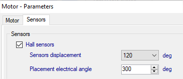

Could you verify your HALL Sensor parameters setting please?
If you agree with the answer, please accept it by clicking on 'Accept as solution'.
Best regards.
GMA
der.ule
they are as shown (120 & 300) , I try varying the "placement electrical angle" from 300 down to 0, but I didn't see much change.
EDIT: My last statment is wrong, I did the tests changing the value directly on the "pmsm_motor_parameters.h", changing it on the Motor Control Workbench, did change the way my motor behave the waveform however, still looks similar.
GMA
And "Sensor displacement" is the correct one I assume...
Best regards.

Yes, I left it at 120 following the recommendations of the UM1052 and looking at the output of the hall sensors shown above.
