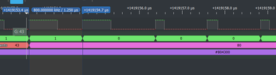

I'm trying to drive the PWM of an STM32G0 but the waveform generated had an inconsistent period between bit 0 and bit 1, and I can't understand why
I'm using TIMER 4 on Channel 2. On the main.c I'm initializing MX_DMA_Init

But for some reason I'm seeing a the strange, not correct, waveform
Am I doing something wrong?

Expected waveform has a bunch of 1 and 0 encoding the LEDs colours for istance
Instead the one I previously upload has only zeros.
System clock is 48Mhz (HAL_RCC_GetSysClockFreq and HAL_RCC_GetPCLK1Freq both return 48M) so the period for each beat should be around 1,25us
For a '1' bit (PWM_HI = 38):
  • High time: ~0.79μs (38/60 × 1.25μs)
  • Low time: ~0.46μs (22/60 × 1.25μs)
  • Total period: 1.25μs
For a '0' bit (PWM_LO = 19):
  • High time: ~0.40μs (19/60 × 1.25μs)
  • Low time: ~0.85μs (41/60 × 1.25μs)
but instead I'm seeing different periods. Below a working PWM generated by DMA
WHat do you mean with Try longer times, or higher system clock frequency. ?

gbm
Principal
Timer DMA expects 32-bit samples. You are preparing 8-bit duty values, then writing them as 32-bit words - that doesn't make too much sense - 4 values are written as single 32-bit duty value.
Sidenote: it is much easier and more memory-efficient to use UART or SPI instead of a timer for controlling WS2812-alikes.
My STM32 stuff on github - compact USB device stack and more: https://github.com/gbm-ii/gbmUSBdevice
