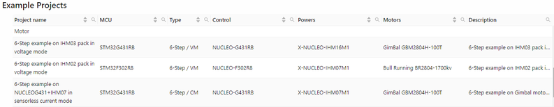

If you open MCSDK 6.4.1, there are several example BLDC related projects.
Hi, and documentation :
User Manual MCSDK documentation - STMicroelectronics Community
Best regards
Fabrice

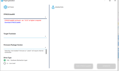

Hi
Thanks for your response.
As I have already installed but I am unable to generate a project from example project.
B.R
Ashish
As the image mentions you have to install the software's related to code generation, there are some posts in the community regarding the issues in code generation, maybe you need to refer them.
Yes First I select the example project the I generate the code is it the right method to follow?
Because I want to understand code implementation of one of the exampl.
