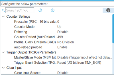

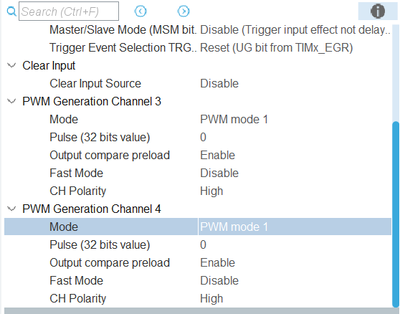

I am using stm32g431c8u6 microcontroller . I have enabled timer 2 channel 3 for alternative pin of PB10 and I have enabled channel 4 for PA3 pin. I set counter perioud 499 and prescaler value =0.
When I plug the debugger and run the code only channel 4 generate PWM signal and channel 3 does not generate PWM signal.

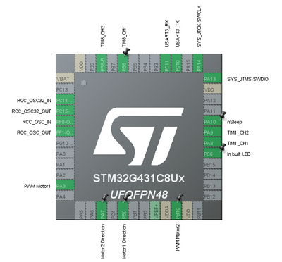

I am using DRV8845 motor drive to control 2 motors. It has two direction pins t control two motors. Below I linked the MCU pin configuration.

TIM2->CCR3 = 400; //out_pid;
TIM2->CCR4 = 400;//out_pid;

waclawek.jan
Read out and check/post content of TIM and relevant GPIO registers.
Tashenlrana
In above MCU pin configuration timer1 and timer8 are used to count pulse count for encoders and nSLEEP pin is a low power mode pin.
Motor direction pins are PA7 and PB0.
I don't think these were information relevant to the problem in original post, i.e. no PWM output signal on PB10 as TIM2_CH3.
Read out and check/post content of TIM2 and GPIOB registers.
