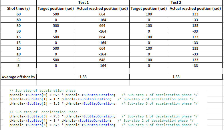

Hi, it looks like it is not as straightforward as we thought, I have made the change as below and I am indeed seeing this change taking effect if I monitor the speed of the motor however the position reached is not as requested by the function. I am using Motor pilot to plot the graphs and below is the result of some tests I have done. Do you think I need to make any additional changes to the code? I have tried to scale the requested position by the error but still no luck to achieve the requested position, I have also tried tuning the PIDs again but didn't help.
Hi, not quite what I was thinking :) I think you should have reduced the number of pHandle->SubStep to an array of 6 (1+4+1) and the SubStepDuration should be the total duration divided by 6 (instead of 9).
Having said that, I've just looked at the trajectory code, and it may be a bit more complicated than that.
You would have to experiment a little there.
