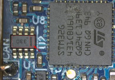

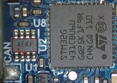

To confirm this I've checked that the CAN driver IC itself is different on new boards - the old one was marked "330" and the new one is marked "AEKF" the other odd thing I've noticed is that the new IC is oriented probably the wrong way - the pin nr1 mark is in the opposite way from the previous generation ICs, but the PCB paths vaven't changed Is this possible that there's an assembly error?  To verify I need specifications for both chips - the one marked "330" and the one marked "AEKF" - I can't find them.
MSzym.1
Here you have the pictures under the microscope to illustrate the issue.
        Pic1: The old version - working                                                 Pic2: The new version - not working
Please give me the specs for both ICs and verify this issue also on your side.

Or is the "AEFK" marking on the not working chip an anagram of "FAKE"?  ;)

So, I've checked in the production files of all board variants (in BOM files) that there should be the U2 => TCAN330DCNT (hence "330" marking on the IC), therefor since there's a different IC in the newest generation of the board, it is a mistake of some kind in the assembly process - a different IC (out of the specification) and/or a wrong orientation of the IC (pin 1 on the opposite side).
LCE
Principal II
That's what I just said:
same pinout, so yes, the assembly is screwed up...
The Maxim and the TI transceivers are pin compatible, but the assembler rotated the new on by 180°. Or someone gave them the wrong assembly files, or whatever...
You could simply unsolder the IC, turn and resolder it.
Or better, give that PCB back and ask for a replacement.

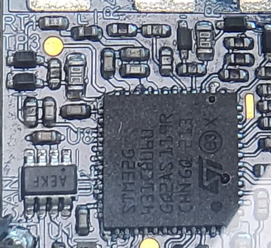

Here's my b-g431-esc1 board purchased around May for comparison.
