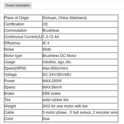

When I flash a code that contain to start the motor (MC_StartMotor1) or press start on ST Motor Pilot, my motor doesn't manage to rotate on its own. It's like it is stuck and need help manually to finally be able to spin.
Any idea what could be the issue and how to solve this?

What is "physical abstraction"? Here is some info about the motor.
I set the generator (supply) at 36V, the current at 3A and the RPM max at 200.

Try setting the speed a little higher. on your document it is indicated 600RPM so the motor can go beyond 200RPM

@Zied b. I increased the speed but it didn't change anything
 @Issamos I increased the current to 5A as you suggested and it worked ! I could also increase the speed from 0 to 400 and it also worked. Is that generally the case? Setting the current at the lowest accepted value may impact the  working of a motor ?
@Gnahore
Happy to now that solved your issue. The current is in a direct relation with the motor torque. The motor torque is basic for engine start.
