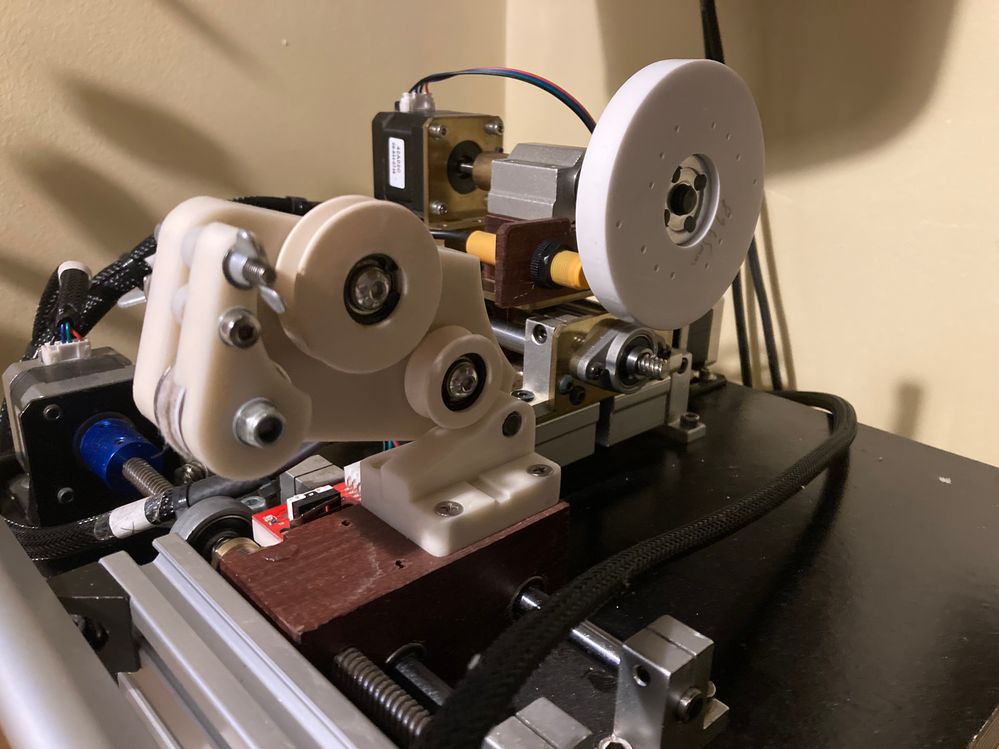

As insight, I am working on a 'hobby' project which requires 4x Nema17 motors (in a 3 axis+Spindle CNC like configuration) in order to wind electric guitar pickups on a 'table top' coil winder. The machine is already (mechanically) finished, working and somewhat tested using code snippets/libraries on the Arduino platform and other manufacturers stepper motor drivers.
In order to develop the project further, I am in the process of moving to a more 'unified' STM only solution. I have, for example, 4x IHM14A1 driver boards (sufficient for each axis of the machine). I have sufficient controllers to hook each driver to a discreet MCU (F411RE in this case). This would seem to me to be 'overkill' in that one, possibly two F411RE Nucleo boards could handle all the required tasks, if the driver expansion boards were stacked and worked independently of each other.
