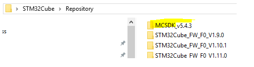

You already need a well-named directory in the STM32Cube repository :
Generally speaking: MCSDK_vX.Y.Z..

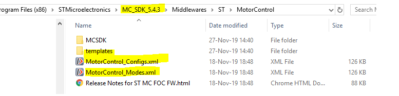

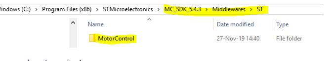

In this directory, you will have to copy the MotorControl directory found in the MCSDK installation:
and have the following content in the tree structure:

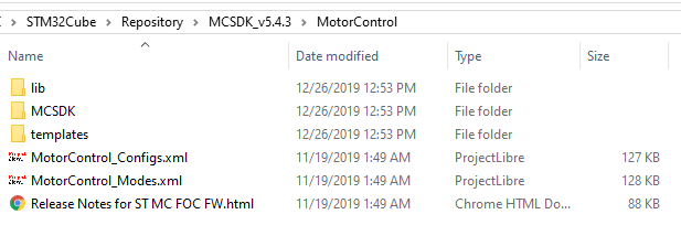

Hi @Nesrine.JLASSI​ , thank you very much for your help.
seems such motor control folder already in place
But still same issue.

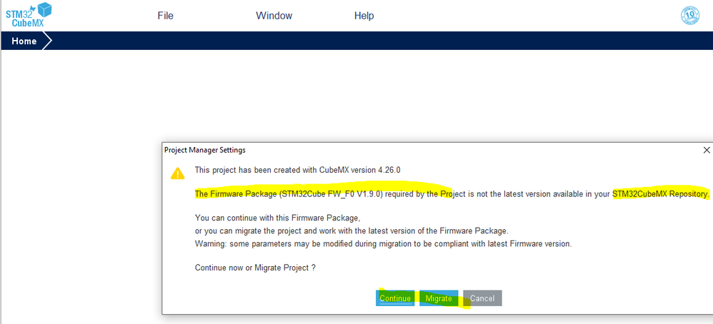

And to make it worst, now have another problem, in a early stage.,

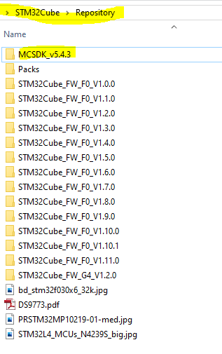

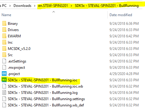

The file that I am trying to open is an example from ST website:
when opening the .ioc file, now it is showing an error that is missing a FW for F0.
But, as we can see on the first picture, I have the most updated FW.
Then, choosing continue or migrate, it will generate the error that was the 1st reason for this post.
Regards.

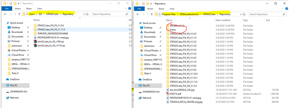

‎2020-05-09 1:05 AM
Hi @Nesrine.JLASSI​ today, I notice something interesting.
I saw that, somehow, during the installation, it was created 2 repository folders
One of them had the MCSDK folder and the motor control files and the other one hasn't.
Even after comping the MSCDK folder to the other one, still not working.
Do you have any other guess?
