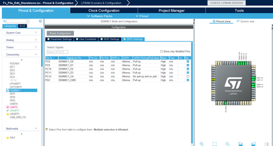

I am trying to initialize SD card with FileX middleware standalone with my Nucleo-U545RET6Q board.
I have initialized SDMMC1 with SD 4 bit wide , 48MHz with 0 divider. Later i had to put divider by 2 because the code was stuck at fx_media_open(); here is the picture:
Later I have initialized the FileX middleware with SD interface, without changing any parameters. I then, edited the app_filex.c using code found with RTOS Based SD File edit program in U5 families.

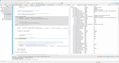

My program runs until i go to :
  status = fx_media_flush(&sdio_disk);
  /* Check the media flush  status. */
  if (status != FX_SUCCESS)
    /* Error closing the file, call error handler. */
    Error_Handler();
Here the Errror_Handler(); is invoked, and from the debugger i get these statues with status code = 144,

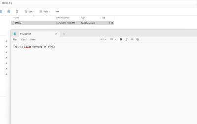

There was once it could successfully write the text file onto the sd card
but again that was once and even that time the fx_media_flush() error occurred.
I wanted to know how can i get around this error, and reliably read write delete files into sd card for a datalogger project.
