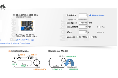

2024-11-26 1:55 AM
Does "Max current" is correct? Does progression bar is stuck? Does MC profiler report an error?
On the other hand, you can directly use the SDK 5.4.8 results to create the your_motor.json file using one of the already existing files (MC_SDK_6.3.2\Utilities\PC_Software\STMCWB\assets\hardware\motor) as an example.

Max current : 10A, btw the power supply says that the average current does not exceed 350mA during the whole video.
The progressbar seems to be stuck.
I did a new longer try and MC porfiler provides a "measurement takes too long" dialog.

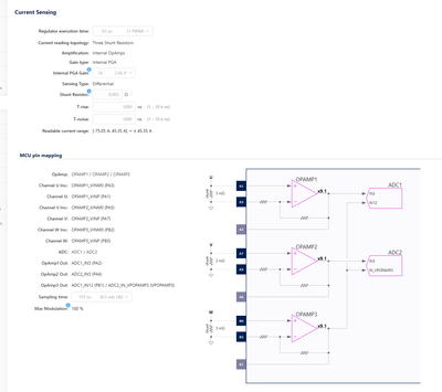

2024-11-27 9:12 AM
I finally found your documentation. Thanks.
I'm using B-G431B-ESC1 standard board. If needed, it's revision C.
And 2 adcs seems to be configured as requested in the above documentation.
Generated CubeMx file seems to be correct according to the above screenshot.

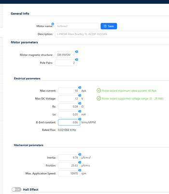

As previously mentioned, could you generate a motor.json file from SDK5 profiling result, check that you are able to generate a functional project with SDK6 and share the json file?
2024-11-28 3:55 AM
Hi
So, I put this settings:
into MCW:
Which leads to this json file :
"hardwareFamily": "MOTOR",
"label": "turbine2",
"description": "Turbine",
"polePairs": 2,
"nominalCurrent": 10,
"nominalDCVoltage": 12,
"rs": 0.24,
"ls": 0.05,
"magneticStructure": {
"type": "SM-PMSM"
"BEmfConstant": 0.86,
"inertia": 9.74,
"friction": 25.63,
"maxRatedSpeed": 10970,
"compatibility": ["FOC", "sixStep"],
"id": "turbine2"

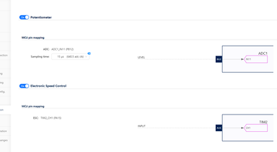

}I activated potentiometer and electronic speed control which settings are coherent with schematic:
Now when I click the button on the board to start the motor, the behaviour looks like while profiling:
https://youtube.com/shorts/QNHE1RNi2oE

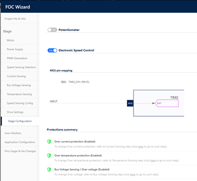

I am sorry but I missed one point, the "beep-beep" is coming from the fact that Electronic Speed Control ESC is enabled:
Could you please try disabling it?
Electronic Speed Control is described in UM2516: Electronic speed controller Discovery kit for drones with STM32G431CB.
2024-11-28 7:33 AM
I supposed that the test you asked was motor profiling.
I disabled electronic speed control (even if plan to use it in the future).
I ran motor profiling. The result is better but not fully successfull. Video below.
I tried several combinations of rpm from 15k to 5k and max current from 10 to 3A. It ends up with firmware fault detected : Speed feedback.
