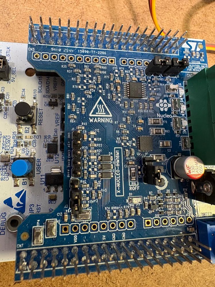

Good evening, I am trying to use a P-NUCLEO-IHM03 pack.

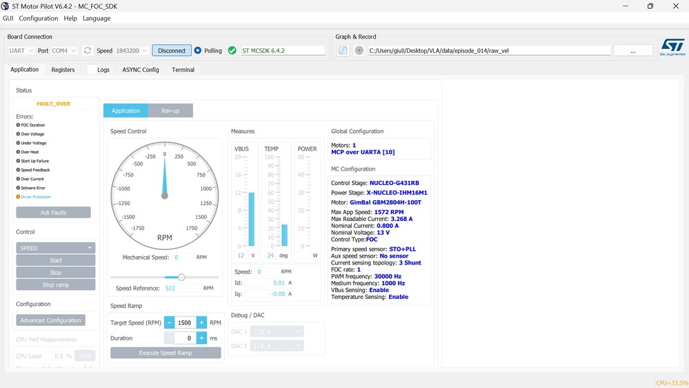

I have generated the project using the X-CUBE-MCSDK version 6.4.2 and STM32cubeMX version 6.17.0, built and flashed the project on the board. The problem is that as soon as I try to start the motor in ST motor pilot, I get a driver protection fault instantly, without any movements of the motor:

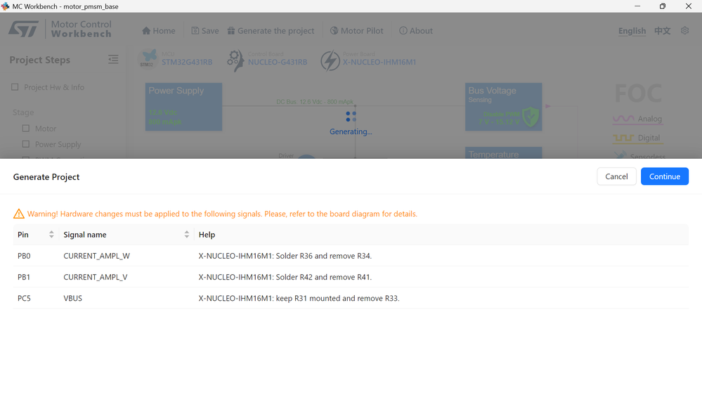

I didn't touch any configuration and jumper of the board, but while I generate the project I get these warnings (I don't know if this coukd be the reason of the fault):
Any help would be very much appreciated, Thanks.
