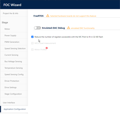

REVUp table setting through Motor Pilot feature is not available for all boards (STSPIN3202 e.g) due to memory footprint constraint.
If feature is not available you will have an error visible on Pilot logs tab.
Please check
If it is the case, un-select box and select in register_interface.c file, the necessary commands for your use case that fits in available memory.

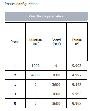

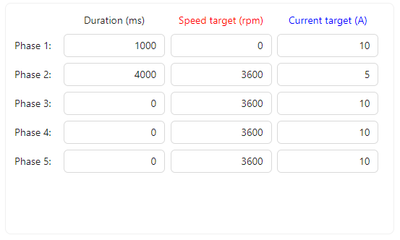

In the MC Workbench the Rev-Up values are set as follows:
The first issue now is that in the Motor Pilot, the values already show up slightly wrong:

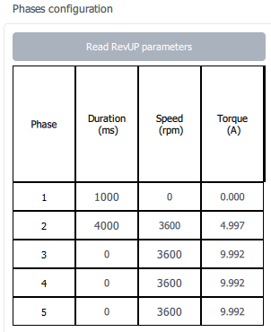

Now when I change the Torque value of Phase 1 to "2" (or 2.000, doesn't matter) for 2A, press enter to apply the value and then press "Read parameters", the Torque of Phase 1 is now 0 and can't be changed to anything else until I power-cycle the device. Same happens for the other Torque values.
I can change the other values (Duration, Speed) just fine, there's only some rounding errors applied there.

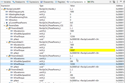

The slight difference on Torque target values comes FW internal conversion from Amps to s16Amps, and Pilot conversion from s16Amps reported by FW to Amps for Pilot GUI interface.
With Nucleo-G431RB/X-NUCLEO-IHM08M1/Dummy motor with max current = 12A on WB6.2.1 and Pilot1.2.5, values are correctly taken into account within allowed range.
As soon, the hFinalTorque value in RevUpControlM1 struct becomes negative (high values not correctly handled on our side), I see the negative value appearing on Pilot GUI, and set to zero when I click on the box.
