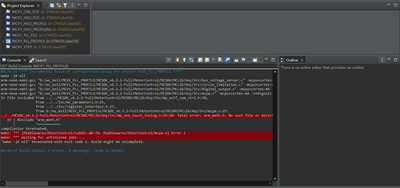

I created a project based on PLL+Profile,  when compile the project, I get a ERROR, about include path. I search the file and add the path(../../Drivers/CMSIS/DSP/Include) into project manaully, compile success. Is this a bug?

As the screenshot shows above, I creat 3 independent projects, MCV1_57_PLL_FOC(without profile), MCV1_57_PLL_PROFILE(with profile). I need to read the codes in these 3 projects at the same time, I will not want to regenerate again and again, it takes too much time. For verifying this issue, based on these 3 stwb6 files, I generate, compile, delete the output folder and repeat again. MCV1_57_PLL_FOC is always ok, but MCV1_57_PLL_PROFILE is always failed.
I have upload the stwb6 and json files, and list version and info below:
Environment Version:
MC Workbench 6.3.2
CubeMX 6.14.1
CubeIDE 1.18.1
PROJECT INFO:
MCV1_57_PLL_PROFILE.stwb6 = MCV1.json + TB 57BL75S10-225TF9HQ.json(unprofiled)
MCV1_57_PLL_FOC.stwb6         = MCV1.json + 57LSPRO2.json(have been profiled)
Thanks for your reply.

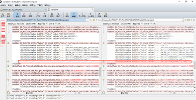

Hello @GMA ,
I repeat as your description and compile success. I notice that "STM32 FW 1.6.1", maybe this is the point, I always used "STM32 FW 1.6.0", and always had compile error. I compare the output folders and  found this, screenshot below, left side is 1.6.0 and right side is 1.6.1. Thanks for your help!
