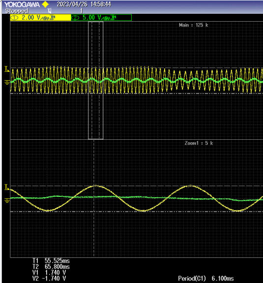

Is 'ke' (coefficient of BEMF) of a stepper motor specified in Vpp, Vp or Vrms?
MBaum.7
According to AN4144, page 14/28, the coefficient 'ke' is measured by turning the stepper and measure the phase voltage with a oscilloscope. For the coefficient 'ke' in V/Hz, which voltage normation should be used:
  • Peak-to Peak, Peak or RMS?.

MBaum.7
Hello Cristina
To clarify - do you mean the Peak to Peak voltage or the voltage from Ground to Peak (half of Peak to Peak). Or to refer to the measured signal in the oscilloscope screen: 1.74 V or 3.48 V?
Hello @MBaum.2gartner​,
I mean peak voltage so in your waveform 1.74 V ;)
If you feel a post has answered your question, please click "Accept as Solution"
