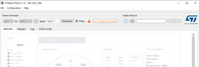

Hi,thank you. When I am trying to connect with GUI Iam facing the following issue. Although my communication port and baud rate are correct.

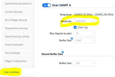

Hello, could you please use the MC Pilot version launch from Workbench:
and set appropriate baud rate according to the value set here:
Please also check the port com by unplugging and plugging in your board.
