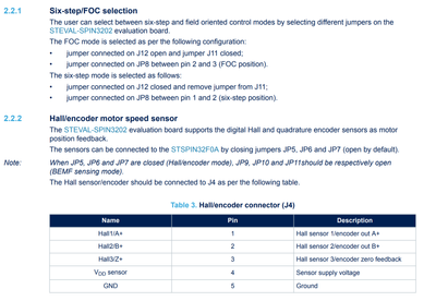

I use the Steval-spn3202 control driver and x-cube-mcsdkh 5.6.0. I use the parameter of bldc motor is 12W, 12000rpm, 0.2A(Nominal current), 24V, 8ohm, 0.488H, 1.95 V/krpm.
I want to control speed control or torque control with foc so that firstly, I selected speed control and senserless(observer-pll) on the st motor control workbench.
I dont use neither encoder nor hal sensor. JP9, JP10 and JP11 closed on the Steval-spn3202. JP5, JP6 and JP7 open the Steval-spn3202.

I think that my fault is that analog pins (A0, A1, A2) is not configuration. these pins goes to back emf volt.I add pistures.Although I tried different parameters
from the software(st motor control bench), I could not enable analog pins.
Can you please help me to this subject.

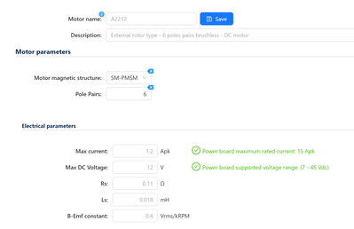

Hello I am facing similar issue .. will list to elaborate correctly
1. Using STSPIN3202 to spin a A2212/13T 1000KV BLDC motor attached motor setup details
2. have connected to 12 V power supply and giving 7 A, it is a sensorless BLDC motor, the motor shaft just twists few degrees and then stops.
3. The error I am getting is this .. MotorControlRegistersBank: Accessing register [2057] OPENLOOP resulted in error[5] . Changing register's access accordingly to avoid getting this error again...
4. Is there any jumper setting that I missed. I am unable to understand if there is any specific setup for sensorless control
Please suggest
