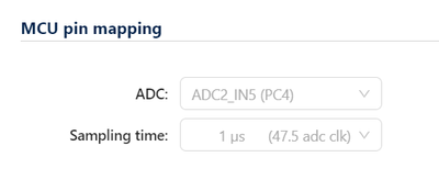

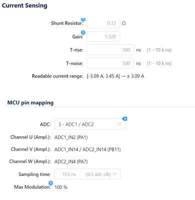

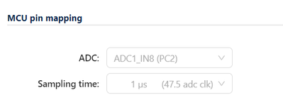

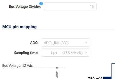

Hi everyone,
I am trying to activate HSO option for sensorless control which as much as I know this feature is to start motor without moving, but I cant activate HSO option with these option in attached.
Zek_De_0-1734882480515.pngZek_De_1-1734882494078.pngZek_De_2-1734882505570.pngZek_De_3-1734882528461.png
I cant find the problem. Thanks in advance.

Hello Zek_De,
Unfortunately, the P-NUCLEO-IHM03 kit is not compatible with the HSO option that requires phase voltage sensing.
You will need to use dedicated hardware boards: STEVAL-LVLP01 and B-G473-ZEST1S-B, which are supported in X-CUBE-MCSDK-6.
Please also refer to the HSO startup guide located in Documentation/HSO_Startup_Guide.pdf.
