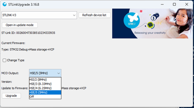

Hello @SeoEngineer
For STM32H7 products, there are the 5MHZ and 6.25MHZ options.
I think 5MHZ will be most suitable one to create 48Mhz for USB
As for your code I recommend that you isolate the USB host functionality. Create a new project that includes only the USB component. In many cases, issues appear to be caused by synchronization problems, where each function works correctly in isolation but causes problems when combined. This test ensures whether the problem is in the USB itself or due to synchronization issues.

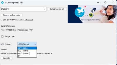

Thank you @Gyessine .
I will test it with the ST-Link bypass. But, I am using a Nucleo board that lacks a populated HSE crystal. Additionally, since I will be powering the board via the VIN pin, the ST-LINK bypass clock source will be unavailable. Are there any alternative clocking configurations you would recommend?

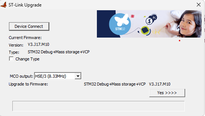

Gyessine
Hello @SeoEngineer
did you ensure that you configured the right HSE frequency in clock configuration
you can select 3 options using update mode.
You can open STlink upgrade window through STM32CubeProgrammer
BR
Gyessine
Hi @Gyessine
Thank you so much for helping me.
The option has 8.33MHz not 8MHz. so I set up 8.33MHz, and it still does not detect the thumb drive. Does it have to be 8MHz?

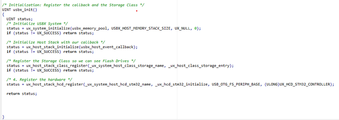

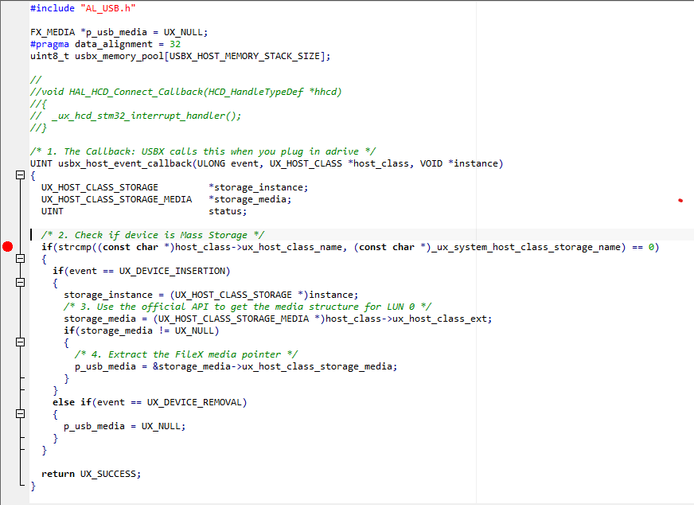

Here is my code.
I call the usbx_init() function in app_netxduo.c/MX_NetXDuo_Init(VOID *memory_ptr) fucntion.
Gyessine
Hello @SeoEngineer
