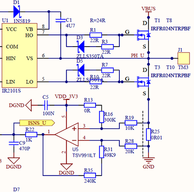

 I designed a custom inverter, based on G473VE, external amplifier and compare, use TIM8 to generate PWM wave, use IR2101S to drive MOSFET. When I try to profile the motor(based on HSO), I get the error: ERROR_DC_AC.
I have upload the screenshot(90e0d582f6e2fb5d5043ff325aab241.png), stwb6 file(MCV1_HSO_PROFILE.rar) and schematic files(MC_V1.pdf). Could you help me please? Thanks a lot!

This issue is caused by the wrong RC filter, recalculate the pole, HSO Profile run OK. @Gael A Thanks for your help!

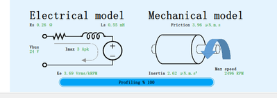

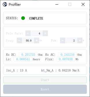

Is this error caused by the negetive Ls? I have used PLL to profile the same motor, the Ls is about 0.55mH.

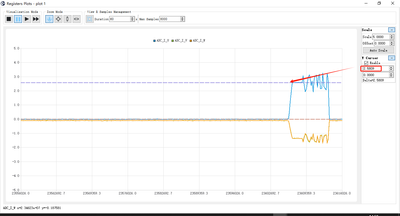

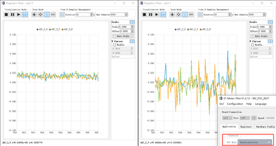

phase voltage and current when profiling(above)
for power of phase U, 2.5A*0.36V=0.9w, for power of phase V and W, both seem to be half of phase U, so the total power is about 2w. It seems to be right.

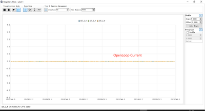

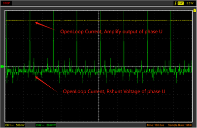

phase voltage and current when "open loop current"(above)
I zoom in the Y scale, I can see many peek on current, but very very week near zero.

Finally, I check the profile result, Rs is about 0.2 Ohm, but 0.36V/2.5A=0.14 Ohm, this is weird again.
I still do not know much about HSO, so I need more advise and notice. Thanks a lot!

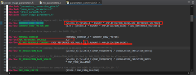

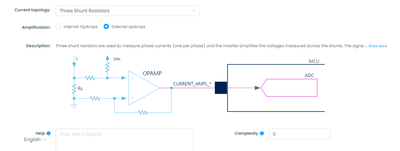

I check current sensing setting, are there some wrong below?
M1_MAX_READABLE_CURRENT is OK, but M1_MAX_READABLE_CURRENT do not have /2, just ADC_REFERENCE_VOLTAGE. please help me check the setting, thanks a lot.

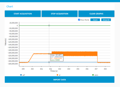

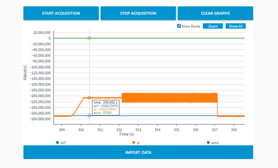

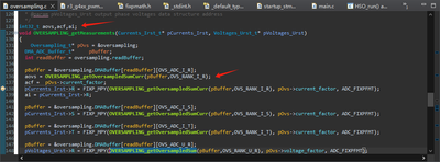

According to the datalog above, the phase voltage seems ok, but the phase current is not. I check the related code, found something below:
I use cubemonitor to trace some values in function OVERSAMPLING_getMeasurements

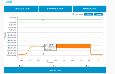

I check 3 points and get different results.
ai = (aovs*acf)>>16 =  (50400 * (-268435456))>>16 = -13,529,146,982,400 >> 16 = -206,438,400 ≠ -206503936.
ai = (aovs*acf)>>16 =  (50384 * (-268435456))>>16 = -13,524,852,015,104 >> 16 = -206,372,864 == -206372864.
ai = (aovs*acf)>>16 =  (50480 * (-268435456))>>16 = -13,550,621,818,880 >> 16 = --206,766,080 ≠-206635008.
what's wrong?

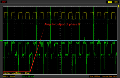

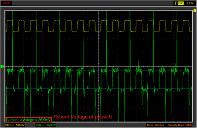

@Gael A I check the current wave of phase U again, the current seems OK.
Rshunt Voltage of phase U = (1.65-1.24)/15= 27mV ≈ 26mV
Current of phase U = 27mV/10mΩ = 2.7A
The datalog indicate that current of phase U is about 2.58A. Everything seems OK.
Also, I check the OpenLoop Current, it is OK. So, what else can I do now?
