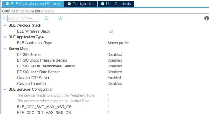

I am trying to build my own BLE application for STM32WB5MMGHx using cubeMX with BLE custom Template , I followed all the needed steps to configure BLE APP the advertising data, services and chars. the projects build but nothing work.
_legacyfs_online_stmicro_images_0693W00000bi6SMQAY.pngI debugged my projects and I found that I didn't get any interruption on IPCC (RX/TX handlers) after initializing the BLE stack.
I tried also to use the same steps with Custom P2P server and it doesn't work for me and I have the same symptoms.

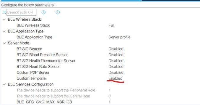

_legacyfs_online_stmicro_images_0693W00000bi6TFQAY.pngIs there any specific configuration and setting to make it working.
Remy ISSALYS
Indeed, there is an extra dot in CubeIDE linker file: *(.MB_MEM2) ; instead of *(MB_MEM2) ;
Due to this, the buffers that need to be in SRAM2 are not placed there, so your application doesn't work. It will be corrected in the next release.

mtaallah
I followed all steps in the video but it doesn't work.
After investigating I found that there's a problem in the linker file ans startup file generated within the project. I used the linker file and startup file from the out of box BLE_p2pserver with my application and it works for me now.
