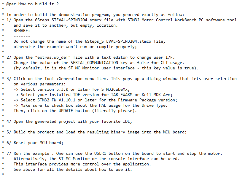

I have been trying to compile the example program "6-Steps speed regulation using the STEVAL-SPIN3204 inverter board" from Motor control workbench.
I have made no changes to the example and following instructions from the text file as it is:

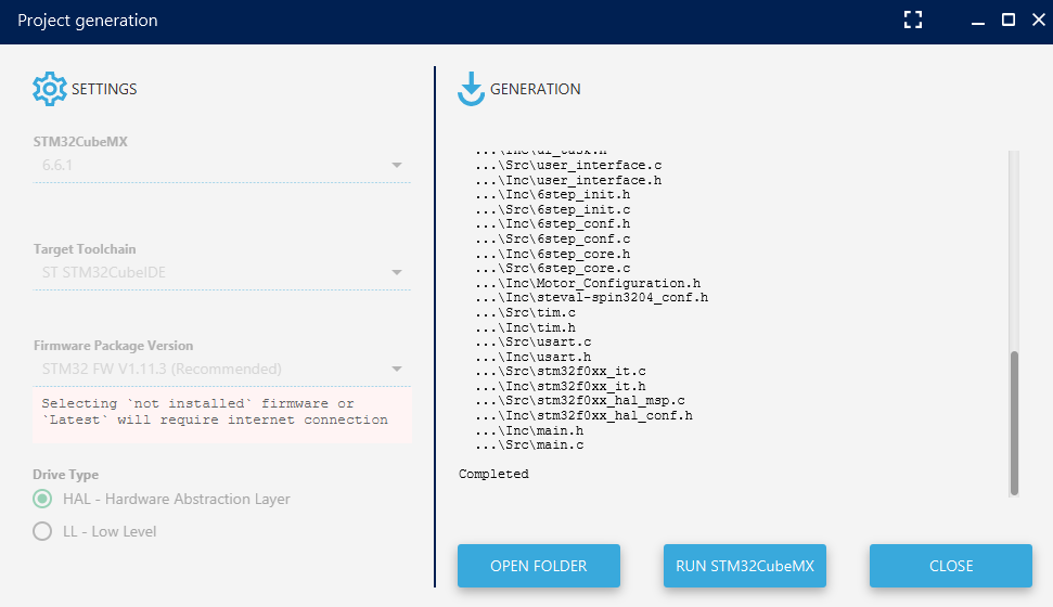

The project is generated successfully:

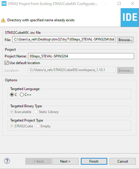

Then I make a new project in STM IDE with the ioc file as follows:

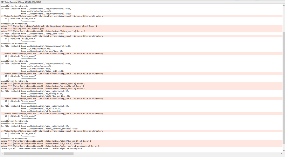

When I try to build the project, I get the following errors:
Can somebody please help, where am I making a mistake?

Now, the way you open the project in STM32CubeIDE is not what I would advise, but the thing is that with 5.4.8, it seems that the project is incorrectly produced.
With 5.Y.4, you would open STM32CubeIDE and go to "File" --> "Open project from file system".
Then, you would navigate to the folder where the project has been generated and use it as the base folder for the project.
STM32CubeIDE will prompt you with two possible project. The one to choose is the the one that mentions `STM32CubeIDE` in its name. For some reason, 5.4.8 does not generate such a possibility. This is part of the issue you unveiled (thanks to you).
Then, you should have a working (at least a building) project.

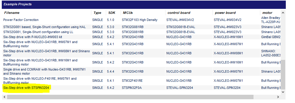

I cannot find an example with that name in neither MCSDK 5.Y.4 nor in 5.4.8. What version of the SDK do you use? What is the exact name of the example you are trying to setup?
Thanks a lot.

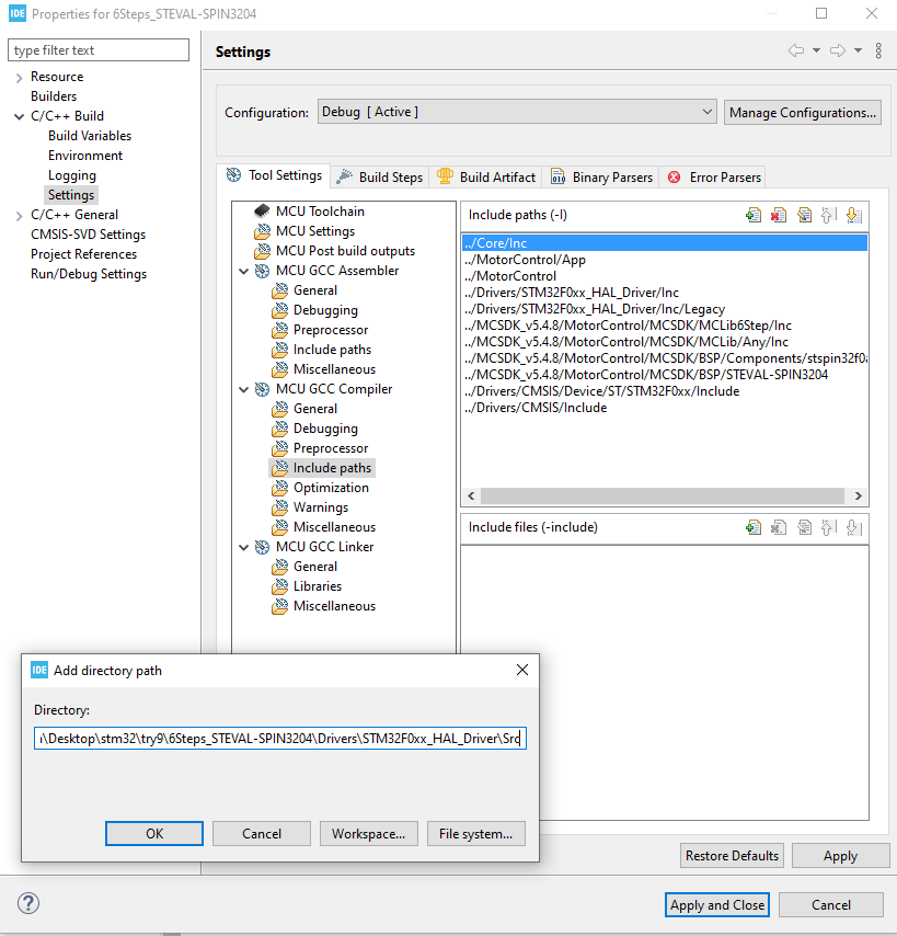

2022-09-29 5:30 AM
Start by checking the include paths and the presence of the one file it complains about. If not copied into the project, check the source directories of the package and copy manually.
2022-09-30 1:27 AM
@Fred V.
I am using motor control workbench 5.4.8 and the name of the example is "Six Step drive with STSPIN3204"

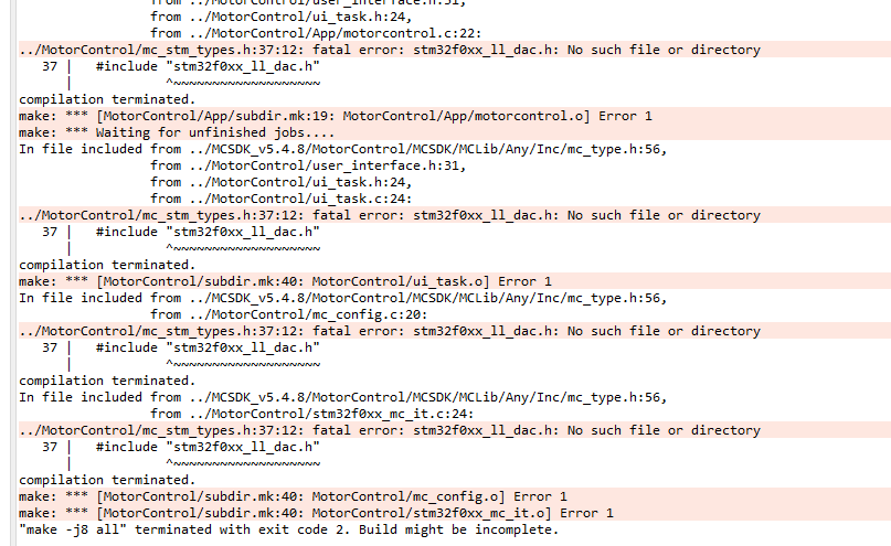

Now I was getting these errors:
I added the new path this way:
Then, I got the following errors:

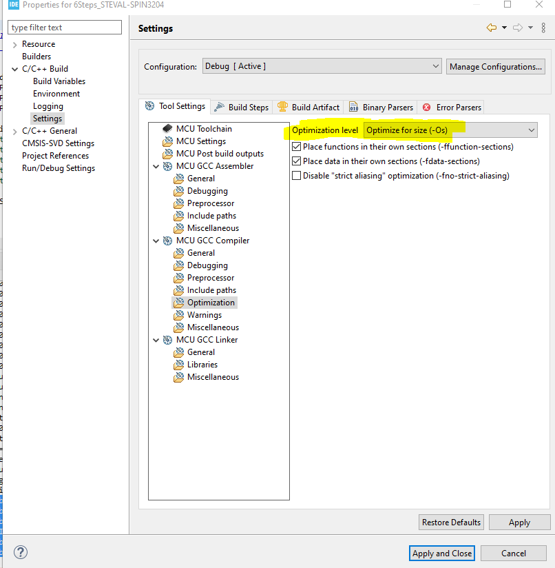

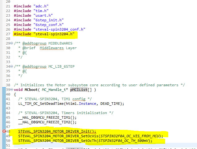

I changed the optimization level of the code:
Now, I am stuck on these errors:

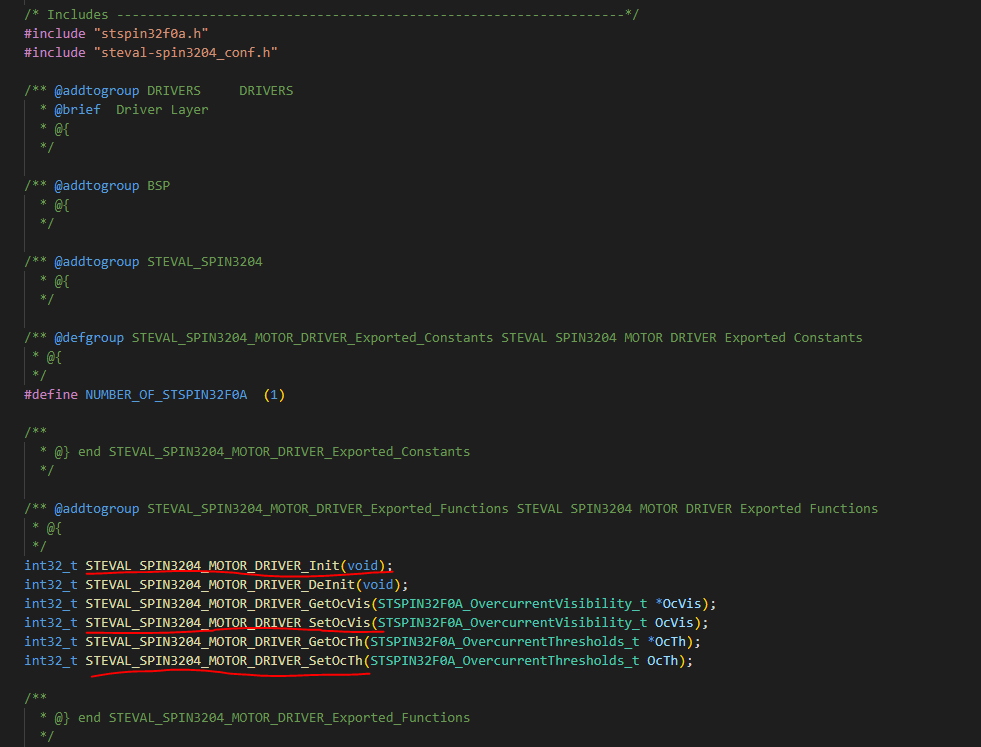

These errors are coming from the following file on lines 48, 49, 50:
And these functions are properly defined in "steval-spin3204.h". This header file and associated .c file is present in the path and also I couldn't find any duplications of these functions. What could be the error?

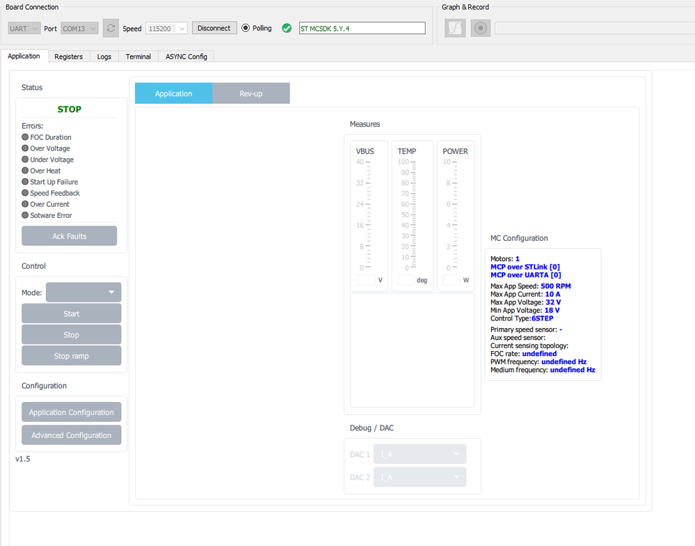

HI @Fred V. , thank you for the reply.

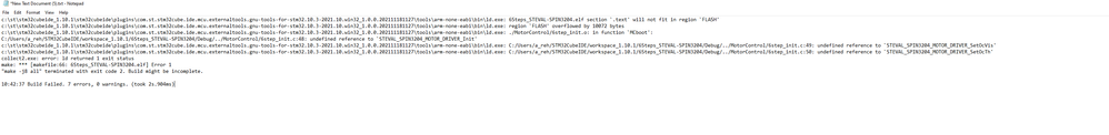

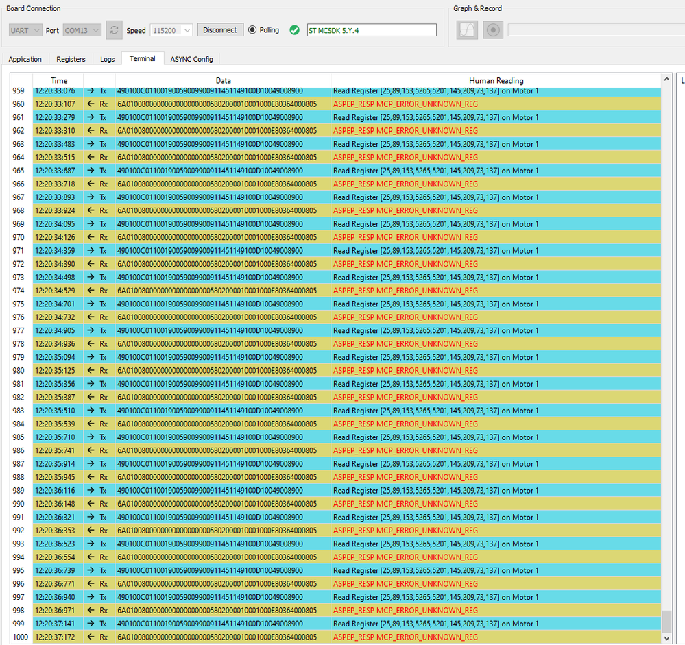

I have shifted to motor control workbench 5.Y.4 and yes, the project built without errors. But then I was unable to connect the board with motor pilot with the error "Port open and try to configure the motor". Based on this post and the provided code in it, the board connected. However I still see some errors, as missing GUI parts and cant select control mode:
Errors in terminal of Motor Pilot:
Apart from these errors, the program worked with the hardware user buttons and thanks I was able to run some small BLDC motors.

2022-10-04 12:20 PM

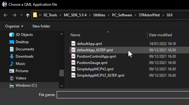

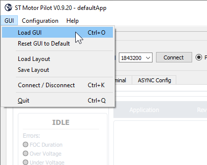

Indeed, 115200 bps on the UART link is a max at the moment with devices such as STSPINF0 and other STM32F0/G0 based MCUs. Hopefully, this may change in the future. The missing GUI parts syndrome seems linked with the errors you see in the Terminal tab: unknown registers resulting from the six-step firmware not supporting all the registers used in the FOC UI would results in making related UI widgets disappear. No more than an intuition here, we'll have to investigate this issue.
Appart from that, the UI screenshot you attached in your post does not show the Six-Step GUI application. That most certainly explains part of your problem. The Motor Pilot tool provides several GUI application tailored to specific situation (see here). At installation time, the pilot defaults to opening the FOC GUI. Since you are using a Six-Step application, you should opt for the Six-Step GUI application. To do so, disconnect from the board and select the GUI --> Load GUI menu item.
This pops a file open dialog. Use it to navigate to the place where your MC SDK installation sits and head for the the <code>Utilities\PC_Software\STMotorPilot\GUI</code> folder. There you'll find a defaultApp_6STEP.qml file that you can open.
Then, you can connect to the board again. The UI should work well now. If that is not the case, please, let us know.

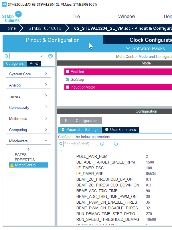

- If I start a new project, will FOC be the default control method implemented? Yes, with MCSDK 5.*.*, a new project will use FOC as the default (and only) control method. If you prefer creating Six-Step projects from the start, use MCSDK 6 that promoted the Six-Step control technique to full citizenship. Then, you'll be able to configure your Six-Step application with the same flexibility as the FOC ones.

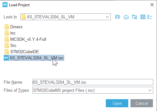

- Changing the motor parameters in the example project. Sure, you can. However, you cannot do it from the Motor Control Workbench (with versions 5.4.8 and version 5.Y.4). You need to open STM32CubeMx and open the IOC file delivered with the example. To do so:
- Open STM32CubeMx and select the File --> Load Project menu item.
- Navigate to the place where you saved the example. Next to the example *.stmcx file, you can find a folder with the same name. In this folder, you'll find a file named 6S_STEVAL3204_SL_VM.ioc, that you can open:
- Once it is loaded, expand the Middleware section in the left pane (Categories tab) and click on "MotorControl". A pannel is open in the UI that displays the parameters of the MotorControl middleware:
You can modify these parameters, save the project back and generate the code by clicking on "GENERATE CODE". If you browse these parameters, you'll see the following motor parameter ones:
- POLE_PAIR_NUM
- LS
- RS
- MOTOR_VOLTAGE_CONSTANT
Some more information is available here about the modification of these parameters:
https://wiki.st.com/stm32mcu/wiki/STM32MotorControl:6-step_Firmware_Examples_User_Manual
I hope it'll help. Please, let us know how things will work.
