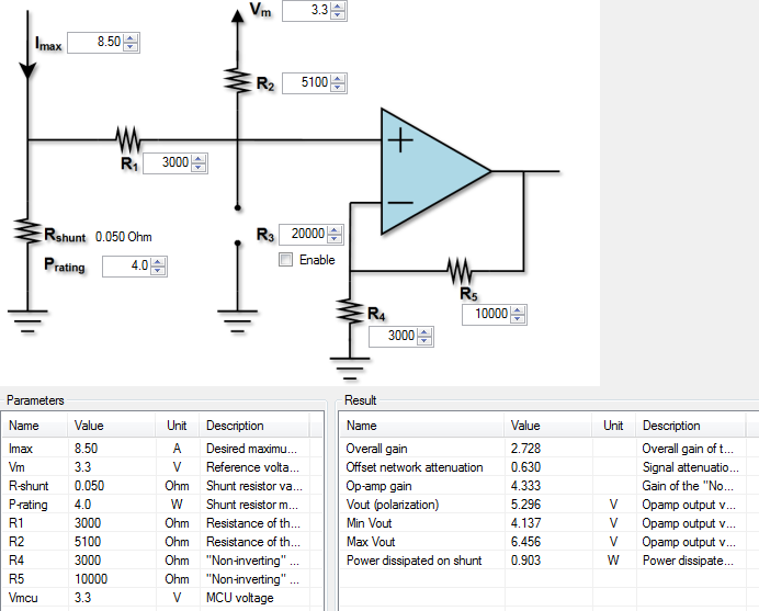

My experiences so far:
  • cannot connect to MotorPilot from 5.Y.4, tried different COM Port baudrates configured both in MotorPilot and CubeMX
  • can connect to Monitor in 5.4.8 with baudrate 9600
  • constantly getting "Over current" failure with 'ding' in a motor, and this motor works perfectly with Nucleo-F446RE and STEVAL-IPM15B
  • I have reconfigured "current sensing", I had to disable R3 (R41 on schematic) and solder R2 (not mounted R39)
  • I have disabled "Temperature sensing" (untick) because it showed me 100C and NTC resistor is not mounted
  • I did play with different "final torque" values in Monitor "Configuration" Tab
Results: click 'run motor', little jolt of the motor and "Over current" failure
