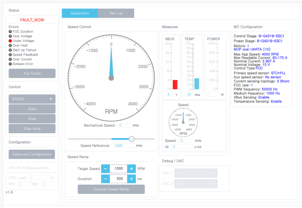

I am trying to run a BLDC motor using Motor Pilot 6.1.1 with B-G431B-ESC1.
Here's my process.
- profile motor using motor profiler
- generate code using mcworkbench 6.1.1 with the values obtained from the profiler
- using CubeIDE, open generated project and click debug + play
- open motor pilot -> Load UI -> MC_FOC_SDK.qml
- connect board (successful, image below)
- connect power supply
- set ramp target = 1500rpm, 500ms
- set speed reference = 2000rpm
- click start
when in IDLE mode, the motor is making a wierd knocking noise, at a rate of 1 sec.
and when I press start, the status change to START, the motor(or the board; I'm not sure) makes beep noise once(for about 0.5s) and the state returns to IDLE.
Please help. Thanks.

‎2023-05-23 12:56 AM
as it turns out my motor is broken. no need for an answer
